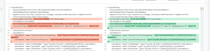

I confirmed that when you click Yes to that dialog it does fire MasterUpdate again and here is the difference between the two
So what you could possibly do is look for in post process the response containing “credit hold” so you really isolate what you do this on. Then if you find that string in the message call MasterUpdate again passing those first two params as false instead of true. Dicey though as you’ll be calling MasterUpdate in post of MasterUpdate. It could go really far south on you.
Easier and safer would be to make those false on the preprocess side, but i’m not sure what other message you might suppress then.

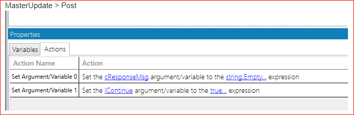

@jgiese.wci Then this should set the dialog to yes
@shobdy I confirmed if you set the lCheckForOrderChangedMsg and lcheckForResponse flags as false in preprocess and cResponseMsg as string.Empty on post process it works as expected, but again it’s hard to know what else you might be bypassing.
No that tells the BO when you call MasterUpdate that there are things it needs to be aware of. That actually needs to be false for the credit logic to be skipped. The dialog being yes or no only happens locally in the screenshot above yes and no only allows the UI to make it through the update method in oTrans. If it makes it through update without you clicking “No” or other flags returning false from oTrans.Update it calls Update again with the first two flag false.
All in all it’s a horribly inefficient design and can explain why you see UpdateMaster called a lot. It controls a lot of this nonsense.
What it’s doing right now is
adapter.MasterUpdate(true, true, “OrderDtl”,…)
That will set the cResponseMessage looking for input from the user and skip adding the order line to the database.
If you click “No” it just drops out and nothing happens, if you click “Yes” it will run master update again like this
adapter.MasterUpdate(false, false, “OrderDtl”,…)
at which time it skips the checking and alerting logic and adds the order line.

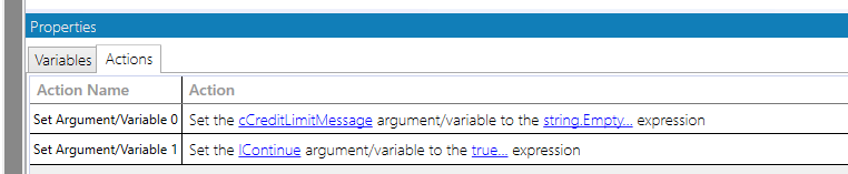

OK… this looks familiar… I think that THIS is the same approach I did in the past. By setting the credit limit message to blank, it stops the message from being displayed by the UI.
I have done that for other messages, but I have never tried that with this one. Tom, have you tried that yet?

All of that logic is self contained in the MasterUpdate and in private methods. I employed your BPMs noted above with the MasterUpdate modifications to hide the OrderDtl dialog and it behaves the same way.
OnChangeofSoldToCreditCheck (works great for initial annoyance) > Post
CheckCustOnCreditHold > Post
CheckCustomerCreditLimit > Post
MasterUpdate > Post

@LarsonSolutions I would try setting these with the bpm you are creating.
Thanks for the reply. That doesn’t work in this case on MasterUpdate. I have those exact settings. In the case of an On Hold customer, it suppresses the message but the update fails to run. It appears to be updated on screen but a refresh will revert to the old data. In my case, the pre process bpms invoke BO ice.ud.update runs and updates the UD table but sales order remains unchanged.
