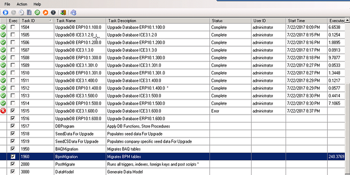

Task 1515 in DB Migration for 905702a to 10.1.600

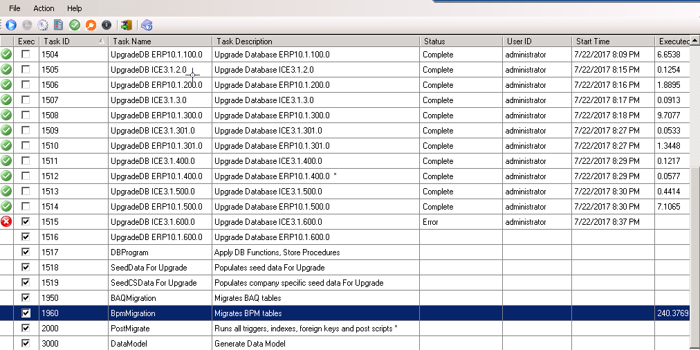

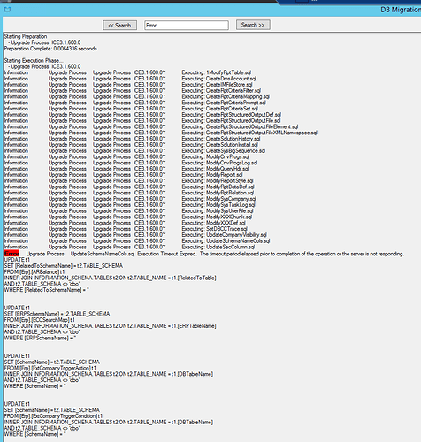

We are upgrading from 905702a to 10.1.600. During the first attempt at the db migration upgrade process Task ID 1515 (Upgrade Database ICE3.1.600.0) had an error (first screenshot). Our first attempt at the migration process was on our current E9 LIVE server. So we restarted the migration process on our new E10 server at Task 1515 and noticed the first steps finished rather quickly, but when it got to task 1515 it stalled and ran for about 4hrs and then errored out with the same error we got on our E9 server. It looks like it’s complaining about one of the SQL scripts it’s trying to execute called ‘UpdateSecColumn.sql’ and the error is ‘ExecuteNonQuery requires an open and available connection. The connection’s current state is closed’ (2nd and 3rd Screenshots)

Did you have multi-company enabled and working in Epicor 9? Could you post the complete log? I am curious if the last step in your screenshot is really where it hangs.

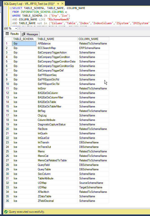

Can you run this part of the query and post the results?
SELECT TABLE_SCHEMA, TABLE_NAME, COLUMN_NAME

It’s getting hung up on the ‘UpdateSchemaNameCols.sql’ script I believe as this is the script I tried running in SSMS and it got to the exact same point as it does in the DB Migration Program. The second error I believe is just a consequence of the first error which is the script timing out.

The snippet of the query I put in the previous post is from UpdateSchemaNameCols and it builds the data for the cursor. This part should run and I am curious if you get 39 rows from it. Could you run just that part?
36 Rows…Executed successfully
