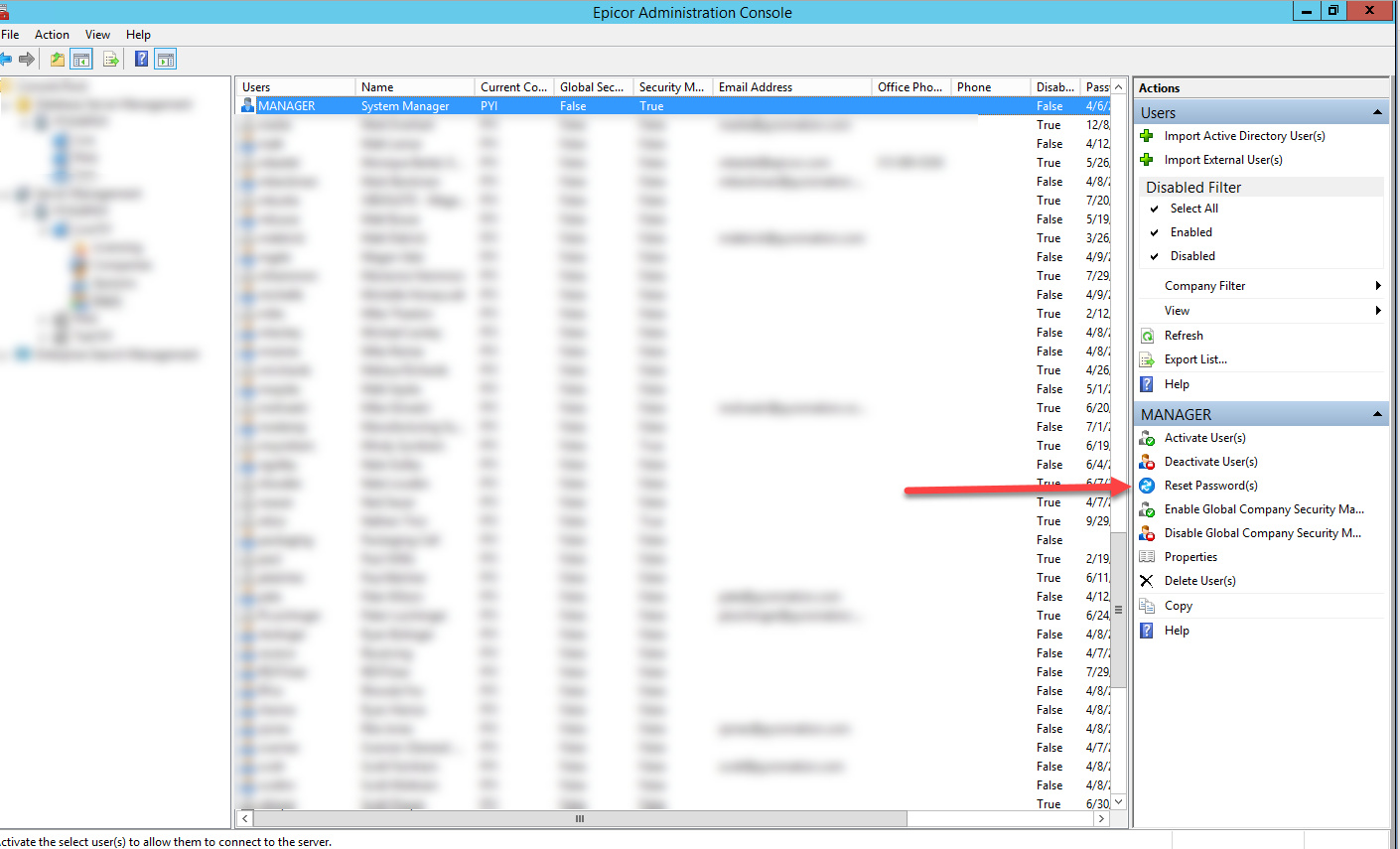

Im not an expert, but I would create a new Security Admin account to use temperary for the taskAgent. Once on E10 in the Admin Console under Server Management (once connected with temp account) you can select the Manager user and reset the password from their.
