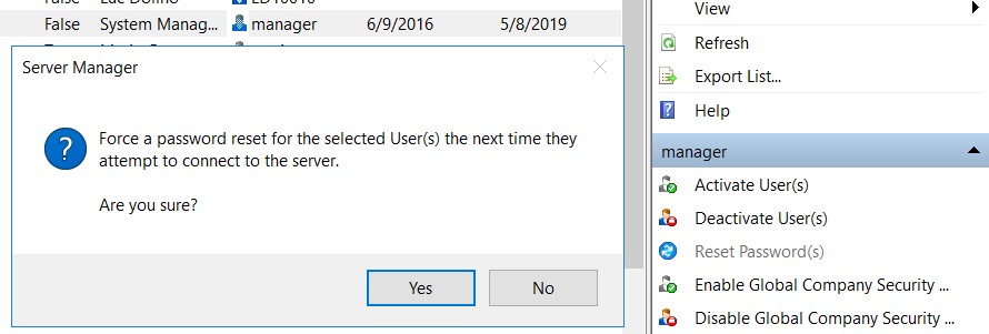

You can reset the Epicor System Manager (“manager”) account within the EAC.
Just go to your AppServer >> Users >> Select “manager” >> Reset Password.
