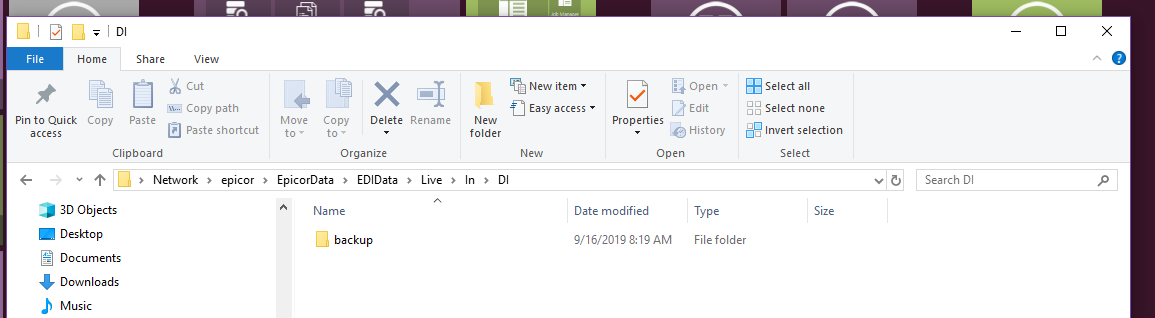

We have EDI set up in our production environment to import demand from one of our customers. I am trying to do some preliminary testing of EDI in our upgraded (to 10.2) TEST environment and I feel like I am missing a piece of the puzzle. I need to figure out where in Epicor the path for the EDI drop folder is specified. Here is the drop folder in our current production environment:

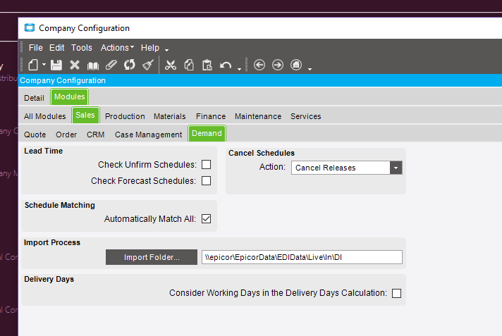

And here is the scheduled task that imports the demand:
Since our upgraded environment is on a new server, I need to create a new drop folder and direct the TEST enviro to look there. But I can’t figure out where to specify the path. Does EDI normally have data or method directives associated with it? I’ve looked on the demand table but didn’t find anything.
