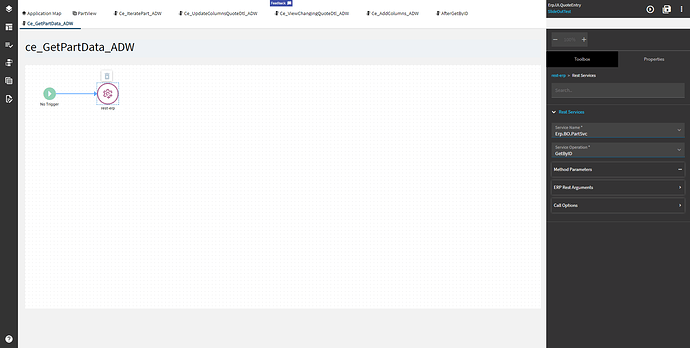

So, I would create a new event. Within that event, leave the trigger node as “No Trigger”, then wire up a rest-erp widget to it.
Find the system event called AfterGetById and at the end of the stuff in there, add a new “Next-Event” node and enter the name of the rest event you just created.
Here’s the AfterGetById (Note that my event is not named the same as the one I’m going to show you in the next images just because I have this wired to something else. Name your event the same as the ID of the new event you’re creating)
These are all Part-based, but adjust yours to be Customer.

On the first screen shot your shared what should be configured on the event-next please?
The value is just the name of the event you created to get the data from.
My example, it would be “ce_GetPartData_ADW”.

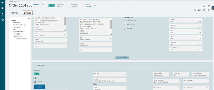

Hi
The first image is the form with the disabled controls, the area with Luceco is the custom controls I have added.
That looks like everything (including native controls) is disabled.

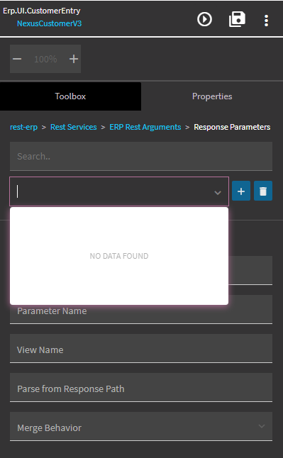

Hi
I am creating another custom for the Customer form I am trying to setup the ‘ShipTo’ data view to display the data and as the same as I was having before the controls I have bound to the ‘ShipTo’ data view are disabled, and when I try and setup the event to call the Rest service the response parameters doesn’t have the data view in the drop down box see the below image.
If someone could help me with this issue please.
Thank you
You have to click the + to add a response parameter.
Parameter Name: This is the table element returned JSON.
View Name: This is the view you’re binding the results to.
Parse from Response Path: as far as I know, this will always be “returnObj” unless it’s a custom REST call.
