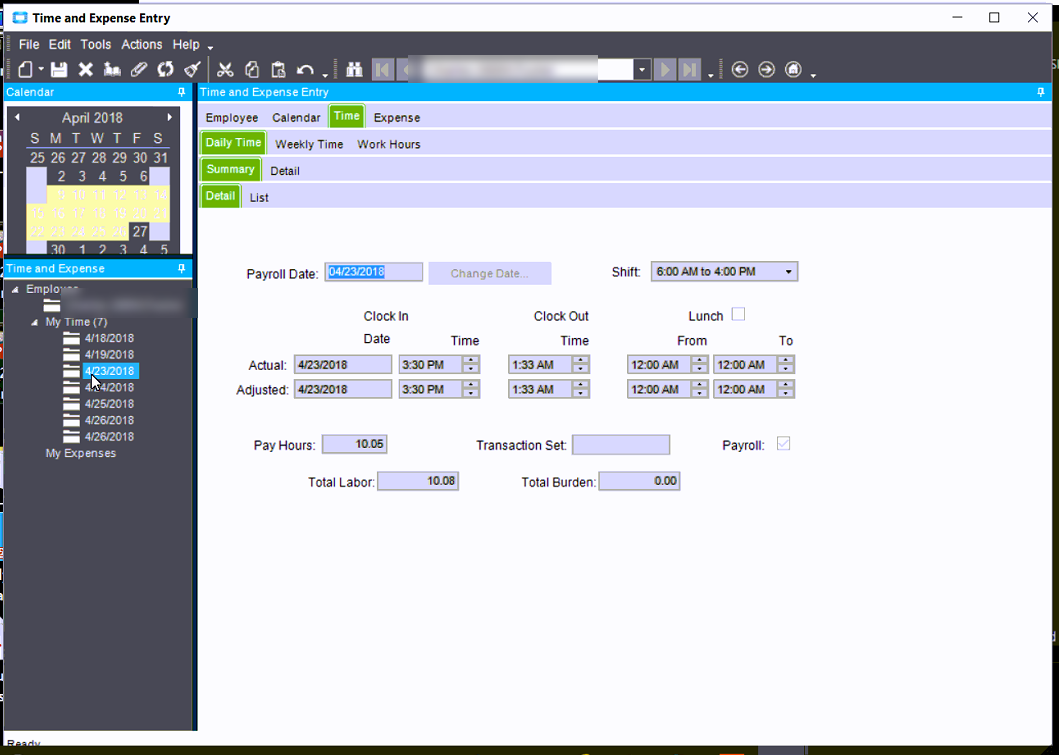

I have one user that can’t alter time details in time and expense.
The user has the same security rights as one of her peers who can.
Her T&E doesn’t even show it as having time details (see screenshots comparing mine and hers).
I’ve cleared her cache and personalizations with no success.
Any ideas what’s going on with hers?
Hers
Mine

Take a look at the tree, though. Her image doesn’t even show that there are details under each day.
In addition, on the calendar, mine will show bold on the days that have details; hers does not.

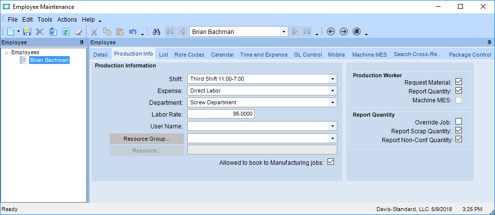

Have you compared the settings in Employee Maintenance?
No problem.
Yes, every tab on their employee file is the same as is the securities in their user account setup.

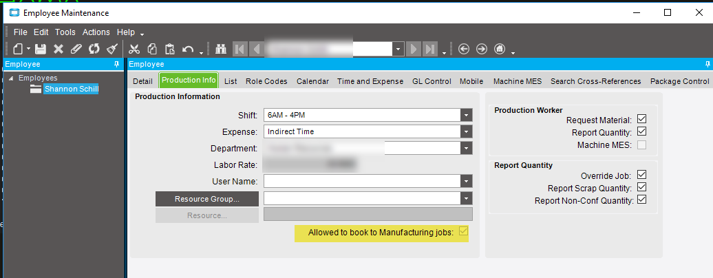

We have been tripped up by not checking the "Allowed to book to Manufactured Jobs checkbox.
@Randy She went AFK, so I’ll have to try that when she gets back.
@DavisStd1 She’s got that marked.

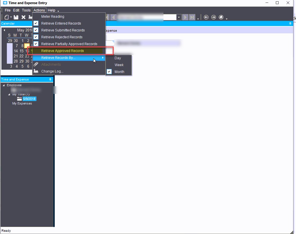

Got it!
The user had “Retrieve Approved Records” unchecked.
All is right with the world again. :+1:t2:
Good find @hmwillett! Talk about being thrown for a loop, eh?
