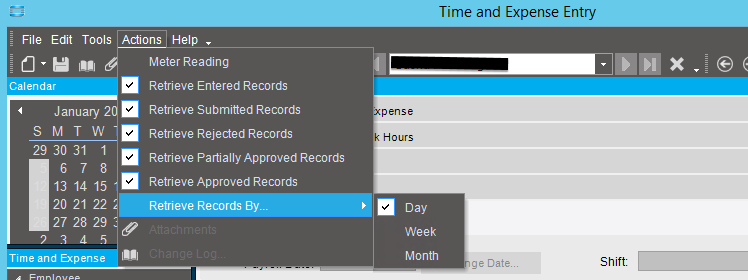

Check if the user is retrieving all time record types from the Actions dropdown.
Thanks! Somehow he managed to uncheck the retrieve approved records and since everything is automatically approved then he didn’t see anything!

Thank you @zwilli526 haha, I was bewildered trying to understand what was happening.
What a great actions menu.
