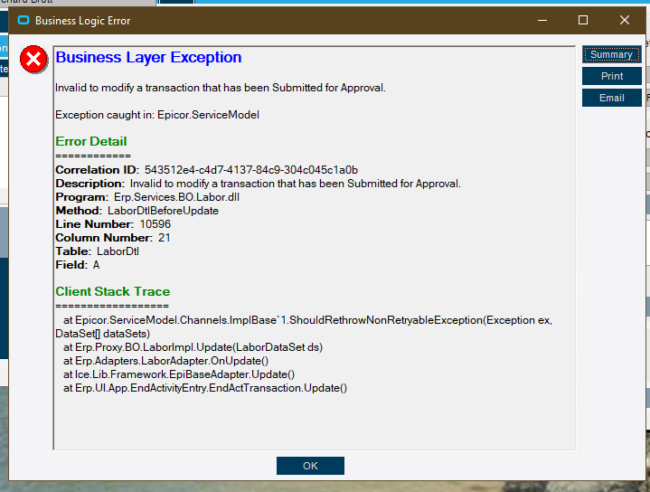

@Chris_Conn What if I get this error? I am not very familiar writing BAQs.

You can’t modify an entry that is approved. You have to recall it, make the change, and then resubmit it. Just like you do in the UI on time and expense entry.
@Banderson I don’t see an option to recall in MES.
You can’t do that in MES, you need to go to time and expense in the full client. It’s not normal that you would give people with only MES access the ability to change time and expense records.
@Banderson, the Time & Expense for that particular employee doesn’t show that transaction. That is why I am having such a hard time deleting or adjusting that specific transaction. I can see it in the Job Tracker, but not in the Time & Expense module.

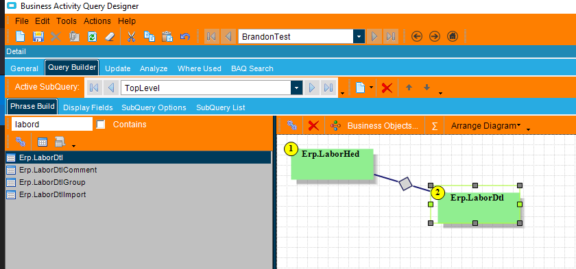

Make sure you are looking at the date for the clock in date, on the header, not the date for the dtl clock in. If they didn’t clock out for a few days, the detail will show a different date than the header. But when you are selecting it in time and expense, it will show on the header clock in date.
If you you make this BAQ, you will see that they are not always the same.
