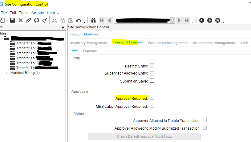

I am not sure if it applies to E9, but in E10 it is here:
Nope don’t have it set there either.
If that check box is not checked then approval is not required at all. If that check box is enabled then each employee must have a supervisor. The supervisor approves the time. If you want auto approval for someone after the box is checked you have to enable it on the employee maintenance screen under time and expense tab.
I think this depends somewhat on what modules you have.
The base time entry has the auto approval set. If you have the expanded
Time and Expense entry then I believe you need to chose whether auto
approve is on or not as Chris has pointed out.
