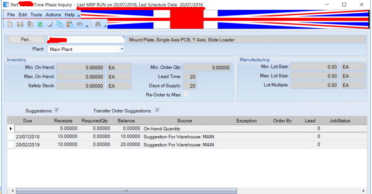

Trying to work out why this part has 2 suggestions when there is no demand?
There are PO suggestions to purchase some of the above material.
Generate suggestions has been run (as was MRP on Friday)
Multi level pegging has also been run
There is no safety stock/min on hand, no fcst and no demand showing

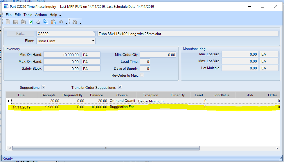

Any idea, to where the table is for this in below image please.
Hi, Your minimum is set to 10000?
yeah , the 10,0000 is just a test. i have been searching all SQL to find this table… no luck yet.
Hi,
I think is one of those screens that collects the information for various tables and shows them on this screen, I don’t think there’s a “Table” for this data it populated on the fly so to speak.
Regards,
John
Hi John,
Exactly what i was thinking.
i wonder if there is a Epicor BAQ laying around some where.
yes, plus any needed -calculated on the fly- values, similar to many Epicor Custom Tracker, so what are you trying to achieve?
The “MRP” and “Generate PO Suggestions” processes aggregate into the PartDtl table, which is the main feed for Time Phase.
The suggestion you’re highlighting is calculated at the end of an MRP or “Generate PO Suggestions” process by subtracting your On-Hand balance from your Min On Hand quantity, and since it’s a purchased part, giving you a purchase suggestion. There is no data table holding that suggestion, it’s calculated when you open Time Phase for that part number.
