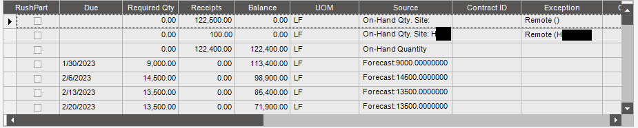

I am encountering a strange issue looking at time phase for a particular part, seeing an extra line at the top with the exception: remote (). I know that remote(name) refers to quantity at a different site than the currently selected one, but I am not sure why I would be seeing an empty site name, in a duplicate qty to the selected site. I have confirmed through Part Tracker, as well as the PartBin and PartWhse tables that the 122k at the selected site, and 100 at site β€œH” are correct values and that there are no other on hand quantities. This part is commonly transferred from site H to the selected site. Has anyone ran into this before, or have any ideas that I can dig into?

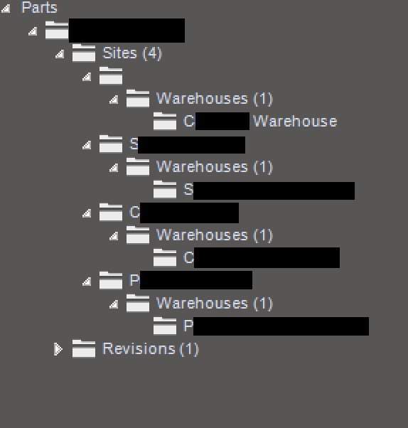

Can you check the Part to see if it possibly has a blank site?
It does! There is a plant record with an empty name, that has one of our warehouses from plant β€œC” attached to it. Time to start digging into transactions to see what could have caused this…
For anyone else running into the same thing: we ended up needing a data fix provided by Epicor to be able to wipe these. We also had a few parts that had the wrong warehouse attached to a plant, which the data fix was able to delete as well.
