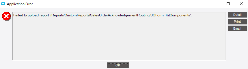

I am modifying OrderAck RDD. I added Customer Table. I create the relationship between OrderHed and Customer with the fields Company and CustNum. This is the error I get when I try to sync data.
What should I do?
Apparently that sync data set button causes more problems than it fixes. There are several posts on it. Rather than syncing the data set, I’ve always just modified the SSRS data set query in the report builder after setting up the new RDD. I would probably make a new RDD, don’t click sync dataset, and edit the query in report builder.
Here’s a good’n
Thanks for that. I used to add them manually but I got tired of it and the data sync helped until this recent update.
Data Sync button should only be used with BAQ reports and not with anything else.
