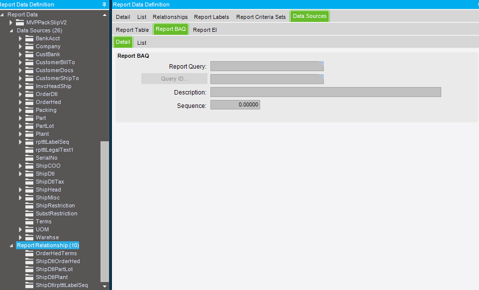

    Here is how i set up the report data definitions.
    Here is how i set up the report style. I am guessing i missed a step somewhere. I did try to set up parameters and it also failed so i removed them. We are running 10.2.500.70

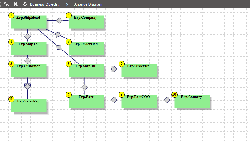

Let’s see that query if you can.

Not sure which one is more helpful.
Yeah, I don’t see much going on in the BAQ either. Does your BAQ return an expected set of records if you run it in the editor? What do you have in place to filter the results?

What information was missing in the RDD? A lot of data is accessible in the RDD if you copy it to a new one.
The SSRS guy (not me) needed some extra stuff like country of origin and our company specific information because we ship stuff over seas. the information was coming up blank, then i built him the BAQ and he was getting all the information that he needed.
I would have your SSRS guy look at the PackSlip rdl to see what parameters are on it and have him create the same parameters in the new rdl.

Latest update we went back to base and copied that. I added PartCOO did we relationship it auto populated the joins on Company and PartNum. Well it is giving me this error when i try to print the report.
Program Ice.Services.Lib.RunTask raised an unexpected exception with the following message: RunTask:
System.InvalidOperationException: The column PartCOO.Company used by the ‘PartToPartCOO’ relationship is missing. Include the column or remove the relationship.

any ideas? if i remove the relationship and go back into the report there are no fields for PartCOO
