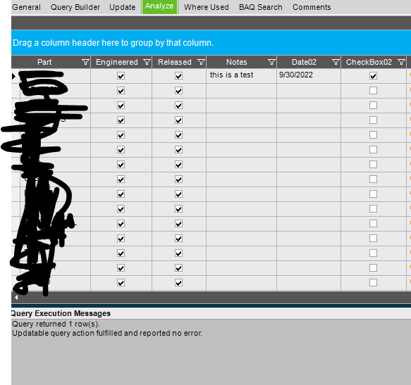

I have a few updateable dashboards that use the Job Head / Job Op tables. In order to update the user has to un-engineer the job, make the change (add the comment), save and then re-engineer the job. doesn’t seem to be an issue when making updates on Job op records, just Job head.
@vfeldt Hi Valorie - I am trying to do what you mention is working for you, which is update the JobOper table (technically a JobOper UD comments field I created) while the job is engineered/released. My UBAQ looks like it will work but does not actually store the data unless the job is unengineered and saved. Can you think of anything special you did to allow the JobOper table to update while the Job is engineered?
@dmccann There is a setting n company config that allows engineered jobs to be updated. If that is acceptable to your company then setting that will allow this update to happen without extra coding.
Thanks @gpayne but unfortunately unchecking that doesn’t work well for us. I was intrigued by Valories statement that specifically they could update the JobOper table but not JobHead while still engineered, because I cannot reproduce that behavior.
@dmccann Are you using the system BO to update or an advance Ubaq? If you are doing advanced how are you updating the UD field? Update Ext or Db.Validate?
I am just trying to use UpdateExt on the JobEntry system BO to update. I didn’t really expect it to work without unengineering the job but thought maybe Valorie had found a magic button I was unaware of that was specific to JobOper . I saw some of the other posts about using an Advanced UBAQ but haven’t had a chance to go down that rabbit hole yet as I am still fairly new to this part of Epicor.
Sorry for the delay we have a site going live and they are WAY behind!
I didn’t do anything special that I can recall. I have a Dashboard in process now (not published yet) that appears to work. I do have the Engineered field from the Job Head on the BAQ and The Dashboard grid and when I test it, it seems to work allowing me to change a UD date and UD Checkbox field without first unengineering the box. When I save and close the test screen then refresh, the data stays.
sorry that’s probably not much help!
Thanks @vfeldt, I appreciate the response. Is it possible to post your UBAQ? I’d just like to see if there is anything unique about what you’re doing with the Jop Op tables. No rush at all and if you can’t, no worries!
Hi Drew;
i’ve attached the BAQ and tested it to make sure I wasn’t crazy. It works in the BAQ as well. I can update Notes(Character02), Date02 and CheckBox02 and then save the results with no error. Didn’t have to un-engineer the job first.
19281-MachiningRelJobs.baq (66.9 KB)
