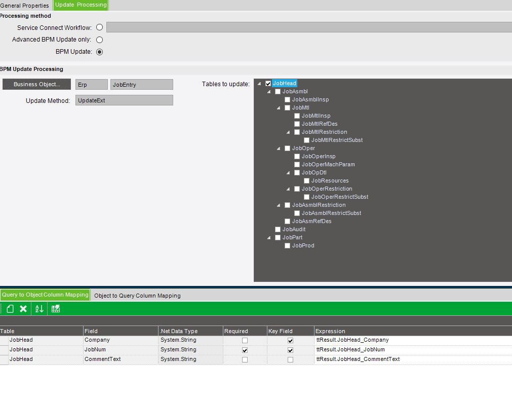

First off you will have to mark your BAQ as updateable:
Then in the Update tab you can set the field to be updateable:
Then in the update processing tab you can select BPM Update and (someone correct me if I am wrong here) Erp.JobEntry.UpdateExt:

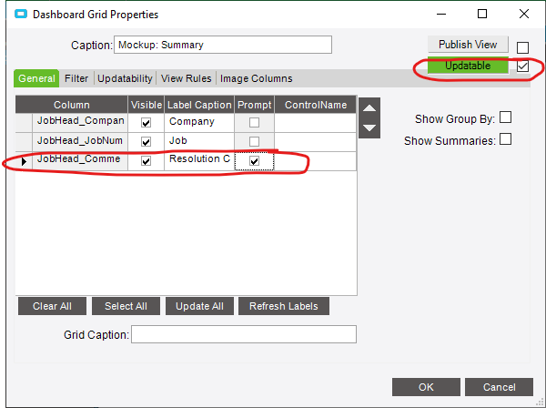

Then in your dashboard you can set the grid to updateable and select the prompt checkbox on the field to make it updateable:
I think that should get you to where you need to be.

You’ll have to select JobOper in this list (Tables to update), and make sure the appropriate key fields are
included in the BAQ.
Mark JobOper.Comment text as updateable as well.
