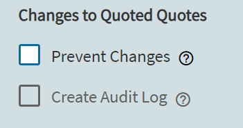

Company config->Modules->Sales-> Quote
Then uncheck ‘prevent changes’.
