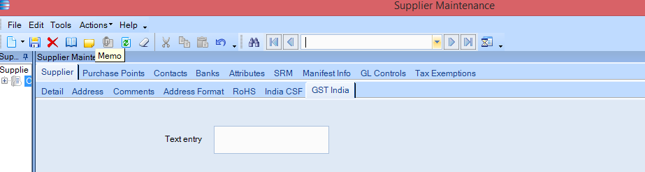

I have customized the supplier maintenance screen for our new requirement. I have to store given text box data to a UD table i.e. UD03. I have created a Dataview for UD03 by keeping parent view as vendorDetails and vendor,vendorID= UD03,key1. Custom field bind to the UD03.character02 filed. **But while inserting the data, it is not going to the UD03 table. Am i missing something ? **
or this dataView is pure view so i only read from it ?
i am new to the UD tables…n doing this type of customization for first tym. I am confused about , if the custom field should be set EpikeyFiled- true / False ?
The configuration screenshots are attached below…
1.Custom Screen
2.Custom filed properties
3. View is readOnly ?

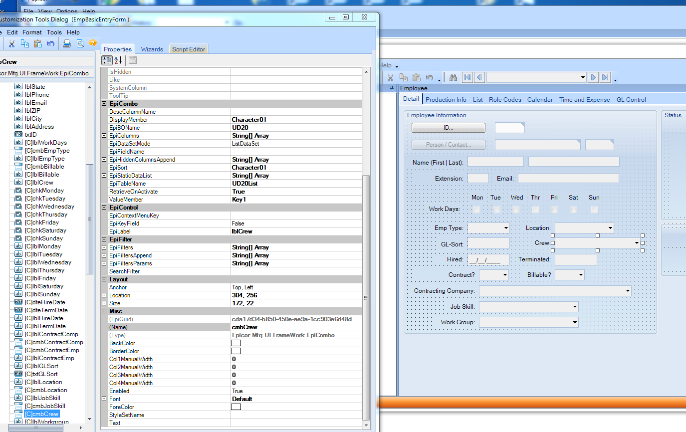

We have some set up use EpiCombo Box. This is what that looks like.I will see if we have one that is just a text field. Most of our text fields are just normal epi binding to a custom field.

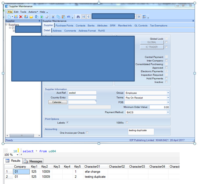

This is a screenshot of my testing your config and it show it works by updating the character01 field.
Note:
You have linked the UD table to the Vendor detail. The combination of the Key columns is what makes the record unique. so while yes it creates another record linked to that Vendor ( because you have clicked NEW UD03 again ) .
Please re-check your solution and see if you missed a step as it should have saved to the UD table character01 or maybe start a new customization?
I don’t know what you are trying to achieve here ultimately. However, I believe this solution will work as stated and yes create multiple records against 1 vendor if you create such. but note Key 5 is incremented distinguishing the two.
