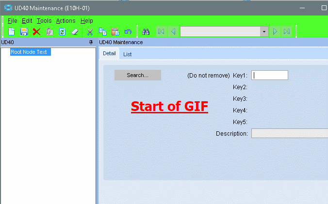

Here’s what I found in 10.2.300.38
Base Form - Key1 through 5 are visible
  • Entering a value in Key1, then tabbing through 2, 3, 4, and 5.
  • After tabbing out of 5, I get the “Record not found. Add new?” dialog
Customized - Key5.Visible = false
  • Entering a value in Key1, then tabbing through 2, 3, and 4.
  • After tabbing out of 4, I get the “Record not found. Add new?” dialog
Customized - Key5.Visible = true (the normal setting), Key5.Enabled = false
  • After tabbing out of 4, the cursor jumps to the Description field (bound to Character01)
  • I do not get the “Record not found. Add new?” dialog
Customized - Key5.Visible = true & Key5.Enabled = true (both the normal setting). Key5 textbox’s Tab stop set to 100.
  • I do not get the “Record not found. Add new?” dialog.
  • The Cursor is in Description field, but it is not yet enabled (because no blank record yet).
  • manually placing the cursor in Key5 *via mouse click), then tabbing out, and I get the “Record not found. Add new?” dialog.

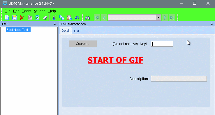

Setting the visibility of keys 2 - 5 to false, does exactly what you’d expect.
Make sure none of the existing records have any values in Keys 2- 5.
BTW - Setting the key’s’ visibility to false, will hide them when the form loads. But as soon as a record is created o retrieved, they reappear
UDForm minimal keys
Instead of using the Visible property, use the Customization Wizard -> Set Extended properties, to set IsHidden = true for Keys 2 through 5. That also automatically hides the labels too.
@ckrusen thanks for the gifs. So i followed your steps but I still had to tab multiple times to get the dialog.
But when i then set Tab Stop to false then it works!
