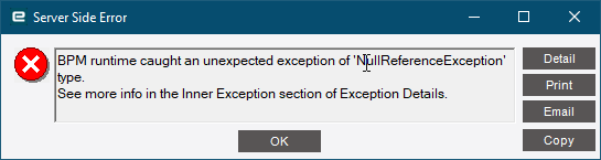

Thanks for the reminder the issue currently is that my GetByID appears to not work I’m getting an null error.
Wonder if that is the second time going through the loop. We were getting those errors while looping through a collection and calling a BO.
Hmm, possible I guess. I’m only seeing my debug messages once when I usually see them multiple times if it loops. I never see “2b” because of the null.
