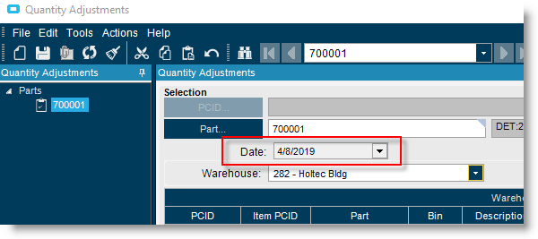

Quantity Adjustment - Date Field is one.
This can’t be set to read only or not visible with simple form settings. It has to be done in the customization script editor after the form loads.
EpiDateTimeEditor epiTranDate = (EpiDateTimeEditor)csm.GetNativeControlReference("69ae2797-0be0-4d26-95b4-378915568aa5");```
epiTranDate.ReadOnly = true;
