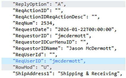

I understand that I need to add the extra row before update. But the closest I get is an unexpected error, which in the Event Viewer just says Object reference not set to an instance of an object.
The thing that is bugging me (pun?) is that the json diff turns up all the fields you all mention but also this one in blue on the second row (the RowMod = U row). And to be VERY specific, you all include the one that ends in Id, but the added field ends in ID (capital D). And it does not want me to add an extra field on only one row!
Or maybe it’s something else. Ugh, so close.

Oh - and that extra ReqUserID field? (The one in blue in the previous post.) Totally irrelevant and a red herring. Ignore that.
