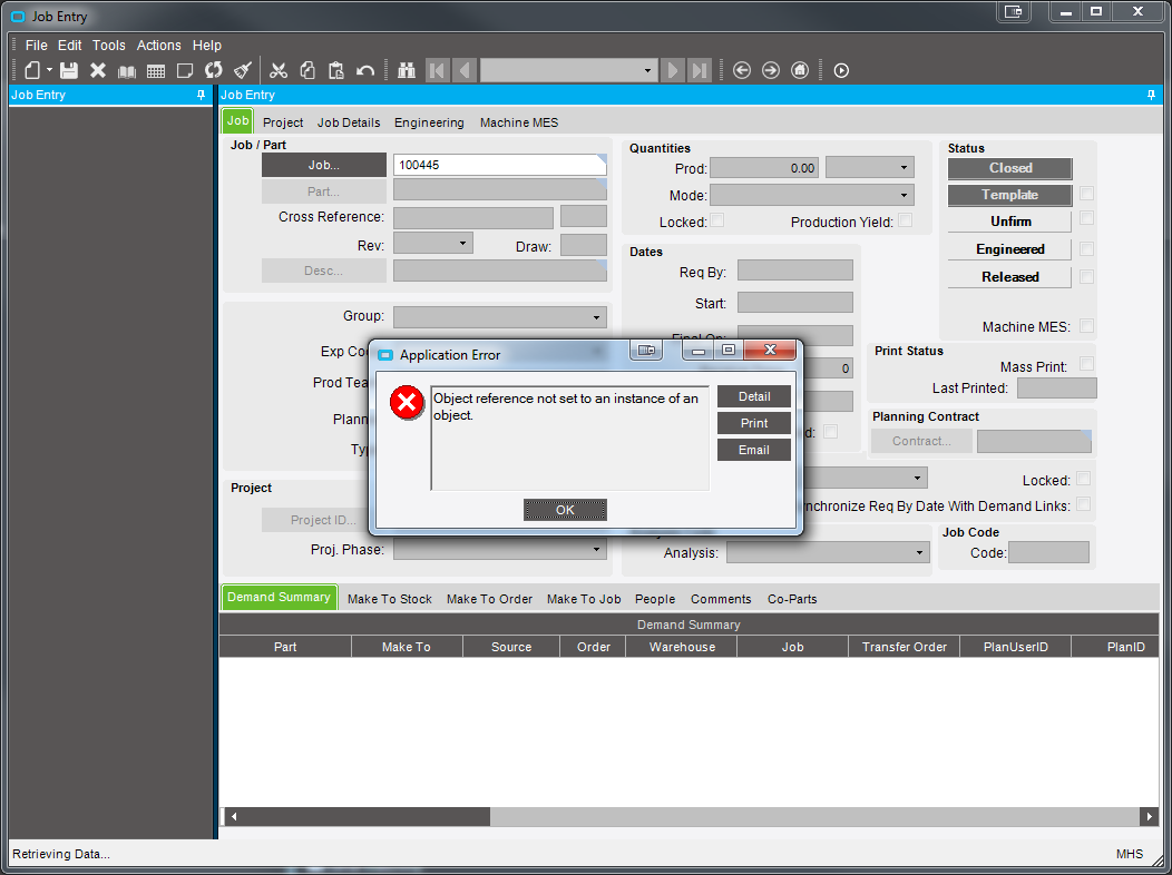

I am getting an “Object reference not set to an instance of an object” error when I try to open a job in job entry or job tracker.
If I type it in directly to the job num field it throws and error. If I search for it and select the job it finds the job but then throws an error.
get same error when I hit ok here.

Is the Job record actually loaded into the form before trying the Open With? From the screenshot, it looks like it’s just the Job Number. I would assume that it would not work unless there is an actual record in the form.
so the screenshots:
The first one I typed the job number directly into the field and hit tab to get the error message.
The job number search screen I click on the job number button and then enter the job number in the starting at field and hit search. the job number shows up in the results.

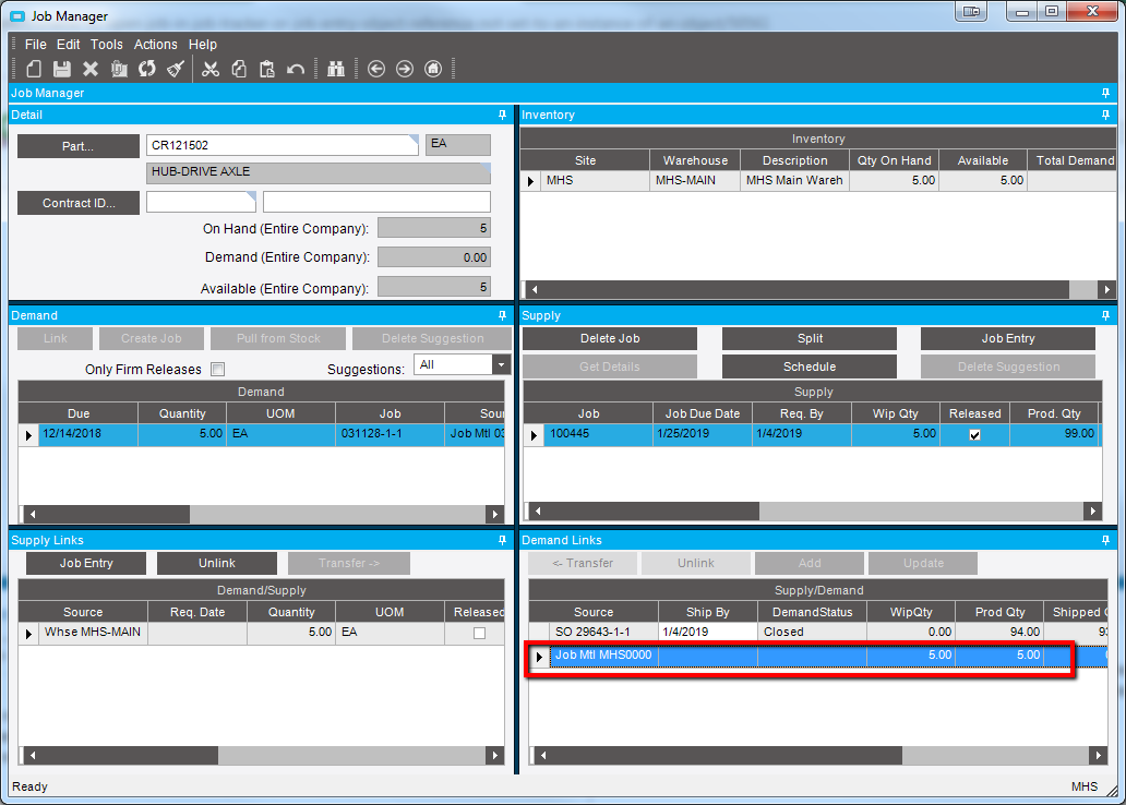

So i open this part up in job manager and I see something very strange.
There is a demand link in the job for an MRP suggestion where this part is a component of a parent part…
That MRP job is not job. Seems like it wasn’t deleted and that demand link wasn’t cleared out correctly.
How do I nuke this demand link if I can’t open the job because the demand link is not valid.

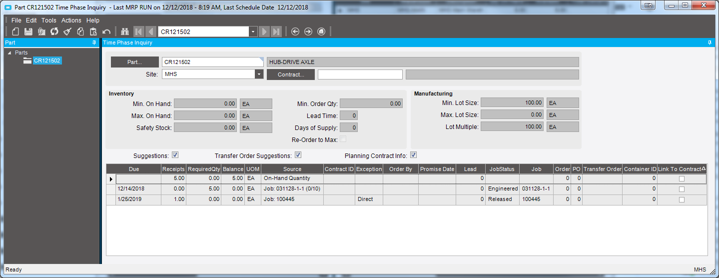

What shows if you open that Part in Time Phase?

I did one of job prod and it is showing the 2 records we can see in the job manager bottom right window of that program

Ok everyone. Thank you for your help on this thread. I found a work around.
So since there was a job demand link out there for MHS00000000111 on my original job 100445.
And there wasn’t a job in my system for MHS00000000111 (because this is an MRP job number and was created, linked and then deleted but the demand link wasn’t deleted).
I created a regular job for this part number.
The error was because I was trying to open 100445 in job entry or job tracker but there was a demand link that was not valid.
So creating the job equal to that job number allowed me to open job 100445 in Job Entry where I could delete the bad demand link. Then I could delete the fake job I created.
