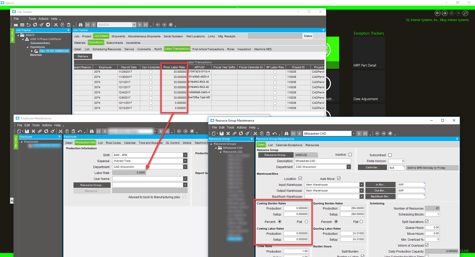

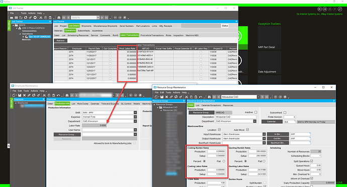

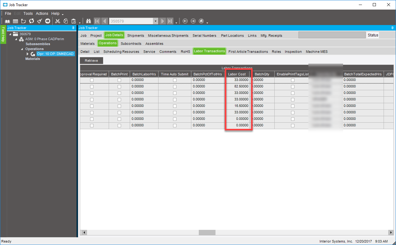

I have a job that is posting labor costs, but these should have all been zeroed out.
Where are these costs coming from??
Any costs on the underlying Resources in the Resource group?
Mark W.
Nope. They are all marked as “Use Resource Group Values”.

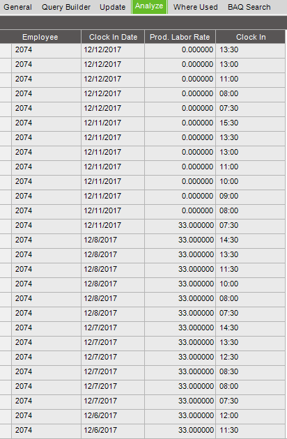

It looks like everything prior to 12/8 has a cost whereas after is $0.
It stands to reason that this employee’s production rate was zeroed out on the 8th, right?
I’m being told everything was zeroed out “months ago”, but it seems like this one was missed and changed later.
Am I way off base with that theory?

Any chance they are coming from the Employee record?
That’s exactly where it should be coming from, but the employee record currently shows $0.00.
Missed that in the screenshot.

I’m thinking this record was missed.
Following @Banderson’s advice, I ran a BAQ. There’s clearly a cutoff.
