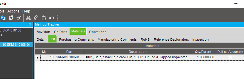

This is where I got stuck. At Jose’s suggestion, I looked at PartMtl instead. So for instance, the very first record in my original report looks like this:
If you look at this in Method Tracker, you get these unpainted parts:
So do I actually want a query off of PartMtl, sorted by touch date, with the Revisions where they are used? Does anything like this already exist in Epicor?
