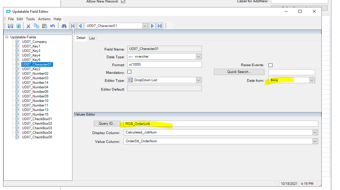

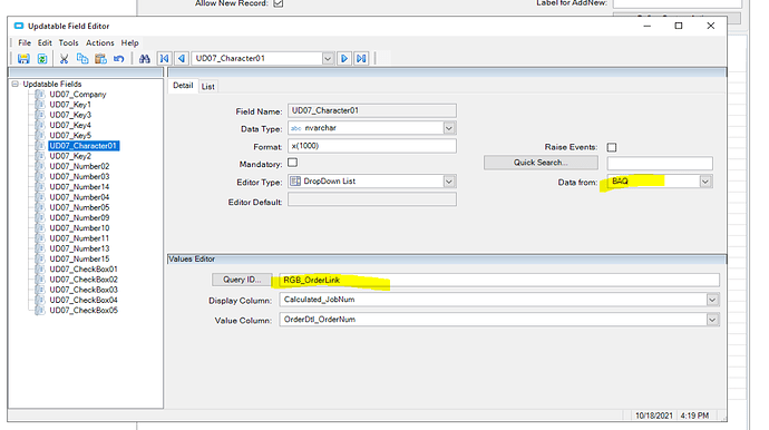

I have an updatable BAQ with Filed Editors to eliminate user error when entering in data. It is a drop and I am pulling the data from another BAQ to populate the drop down. My issue is the updatable BAQ will be linked to Dashboard browser to Order Head order number. How can I make the drop down BAQ populate the order number that is selected in Order head. I cannot figure this out at all the drop down pulls in ever order and I just want it linked to the order number the user has selected.

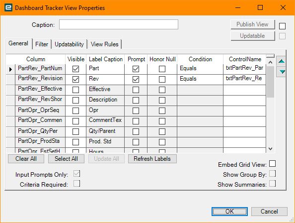

The important part for me was that I wanted to see all the Revs for a part. I made both the Part and Rev fields native to the dashboard in a tracker view. I set both to visible and prompt. This creates native textboxes in my dashboard.
Now open your dashboard in customization mode. Make sure the part and rev fields are set with the correct EpiBindings back to your dashboards BAQ. Hide the Rev text box, by selecting it and changing the Visible property to False. Now add a combo box, and place it where you expect to see the rev combo (where the text box originally was).
