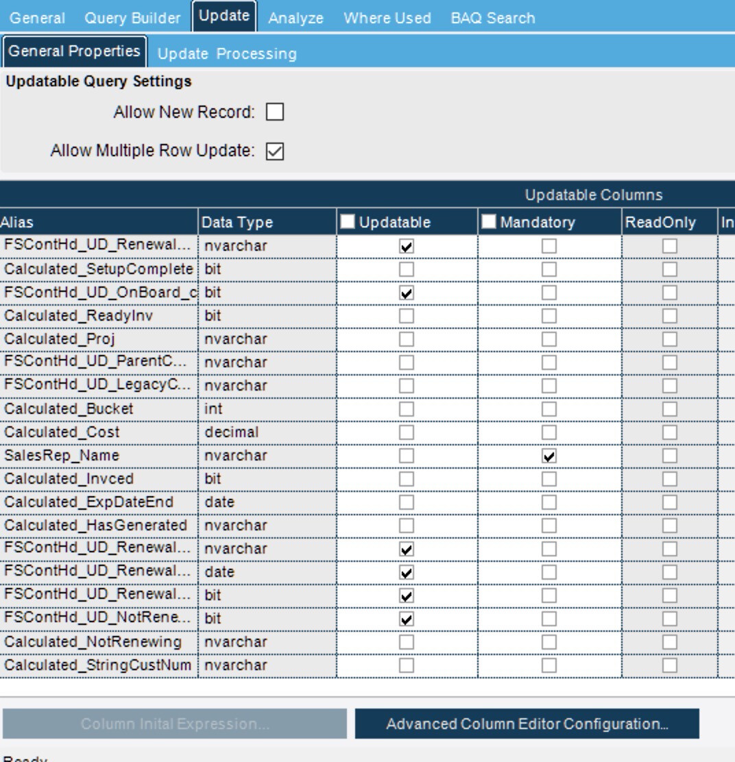

I would avoid the customization and just do this in the BAQ. You can make the fields update able, but don’t actually make it update-able in the dashboard. Then it will automatically be a drop down filter in the dashboard without customization.
