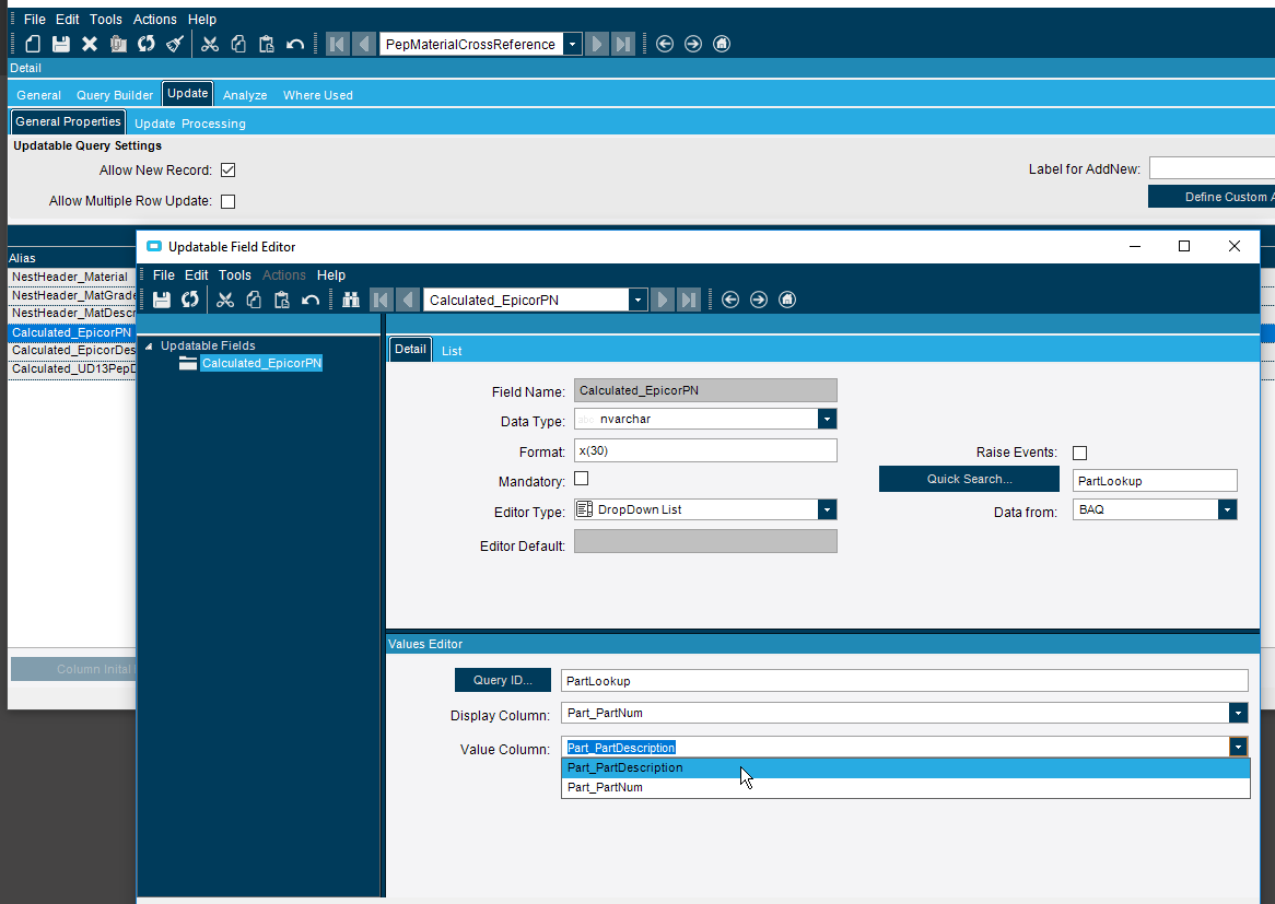

So I’m trying to set some defaults in a UBAQ, I want to be able to use the advanced column editor configuration, but I need to be able to see the part number and description in order to pick the correct part number. Does anyone know if this is possible? Or do I have to go to the dashboard and do the customization there?
Can you just concatenate the two fields in your PartLookup query as a third (display) column?
That’s a good idea. (I should have thought of that.)
