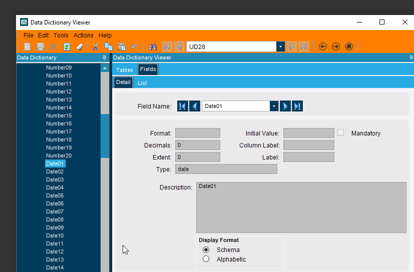

I noticed the UD27.Date01 is specified as Date by default as format setting, (to show, I added Date02 without change)
I changed it to DateTime.
But the update settings does not seem to follow…
I guess that is why the time is not properly captured in the field.
How can I show the time with the date then in a Date UD field?

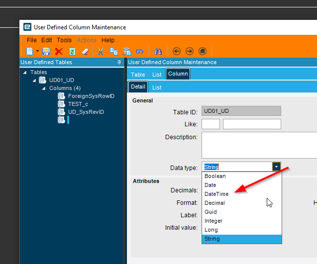

it’s the type of field that’s in the database. You’ll need to add your own UD column if you want the time as well.
I can’t remember for certain, it would need to be tested, but I think for datetime UD columns you can use the sql getdate() in the initial value field to default that without needing a bpm
