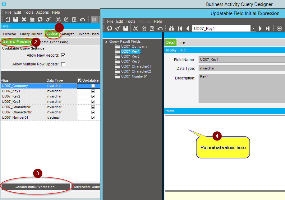

Maybe your missed this feature in Updatable BAQs? (I did for a long time) you can set initial values on the NEW records.
Thanks Tim, that definitely did the trick for UBAQ section.
