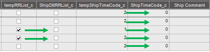

When I run it from the server, I do not get the message, but it still does not update (assuming I should see the fields populated after GetList)

I attempted to update ShipComments with the Company name (thinking the fields themselves are a problem?):
using (System.Transactions.TransactionScope txScope = IceDataContext.CreateDefaultTransactionScope())//start the transaction
    foreach (var ttResultsRow in result.Results)
        var ShipDtl = Db.ShipDtl.With(LockHint.UpdLock).Where(row=> row.Company == Session.CompanyID && row.SysRowID == ttResultsRow.ShipDtl_SysRowID).FirstOrDefault();
        if (ShipDtl != null)
            Ice.Diagnostics.Log.WriteEntry($"In the update TimeCode is {ttResultsRow.Calculated_tempShipTimeCode_c}");
            //ShipDtl.SetUDField<System.Boolean>("ShipDtl_RRList_c",ttResultsRow.Calculated_tempRRList_c);
            //ShipDtl.SetUDField<System.Int32>("ShipDtl_ShipTimeCode_c",ttResultsRow.Calculated_tempShipTimeCode_c);
            ShipDtl.SetUDField<System.String>("ShipDtl_ShipComment",ttResultsRow.ShipDtl_Company);
            Db.Validate(ShipDtl);
txScope.Complete();

But ShipComment is still empty.

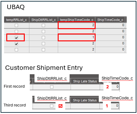

You updated the database, but not the results that come back from GetList.
In customer shipment entry in the list view at the bottom the fields will be all the way to the right. refresh the pack after the update and the data should be there.
Nope – fields are there, but data is not. I even ran it on the server this morning, just in case. I am probably missing something very basic, but cannot figure out what it is and need to move on to some other stuff. Will revisit this later.
