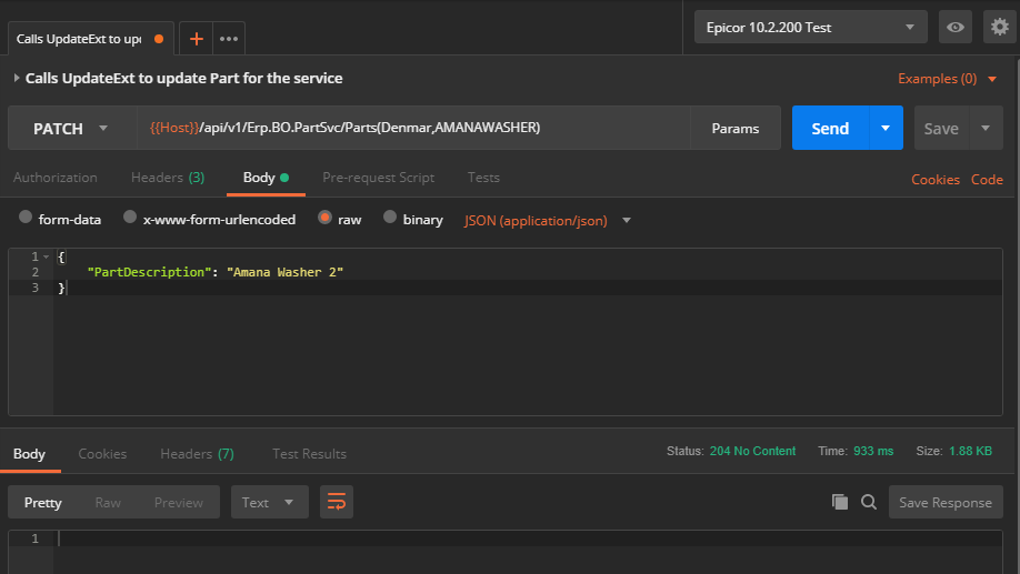

Is there any known issues with the REST partSvc? Im unable to get the methods update and updateExt to work. I am also unable to get oData patch /Parts(company,partnum) to work. I keep getting a null ref exception. I have tested both in 10.1.500.27 and 10.2.200.8. Any ideas would be greatly appreciated.
David
I just tested it on our instance (10.2.200) using Postman and it worked correctly. What does your request body look like?
PATCH URL: https://hostname/instance/api/v1/Erp.BO.PartSvc/Parts(Denmar,AMANAWASHER)
Request Body:
    "PartDescription": "Amana Washer 2"
Response Status: 204 No Content (OK)
Set RowMod = “U” when using Update and UpdateExt, noticed sometimes it doesn’t update without this.
I figured it out. It was one of my BPMs that was preventing an update.
