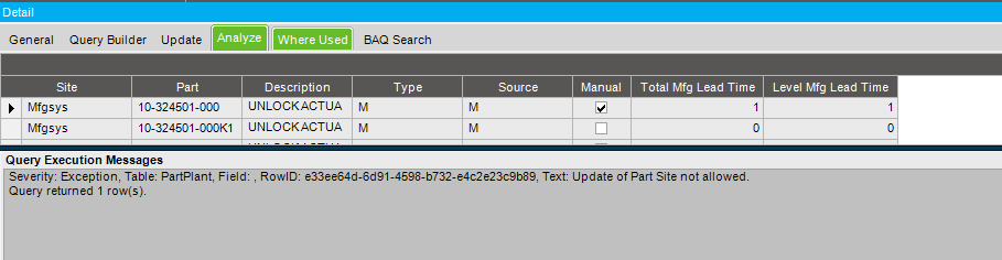

My BAQ appears to be working and when I check the Part it is getting updated but I notices this message. It updated the wrong field…
I created the Dashboard and the Dashboard will not allow me to update this with same error. I have other updateable dashboard for the Part Plant so not sure why this one is not working.

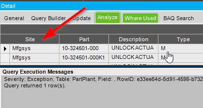

Does your PartPlant table have mixed case for the site field (MfgSys vs Mfgsys vs mfgsys) ?
It could be thinking that you’re trying to change it from MfgSys to Mfgsys
Also, you don’t have the plant/site field set as updateble, do you?

And yes we have a mixed of MfgSys and Mfgsys…I guess I need to update everything to one?

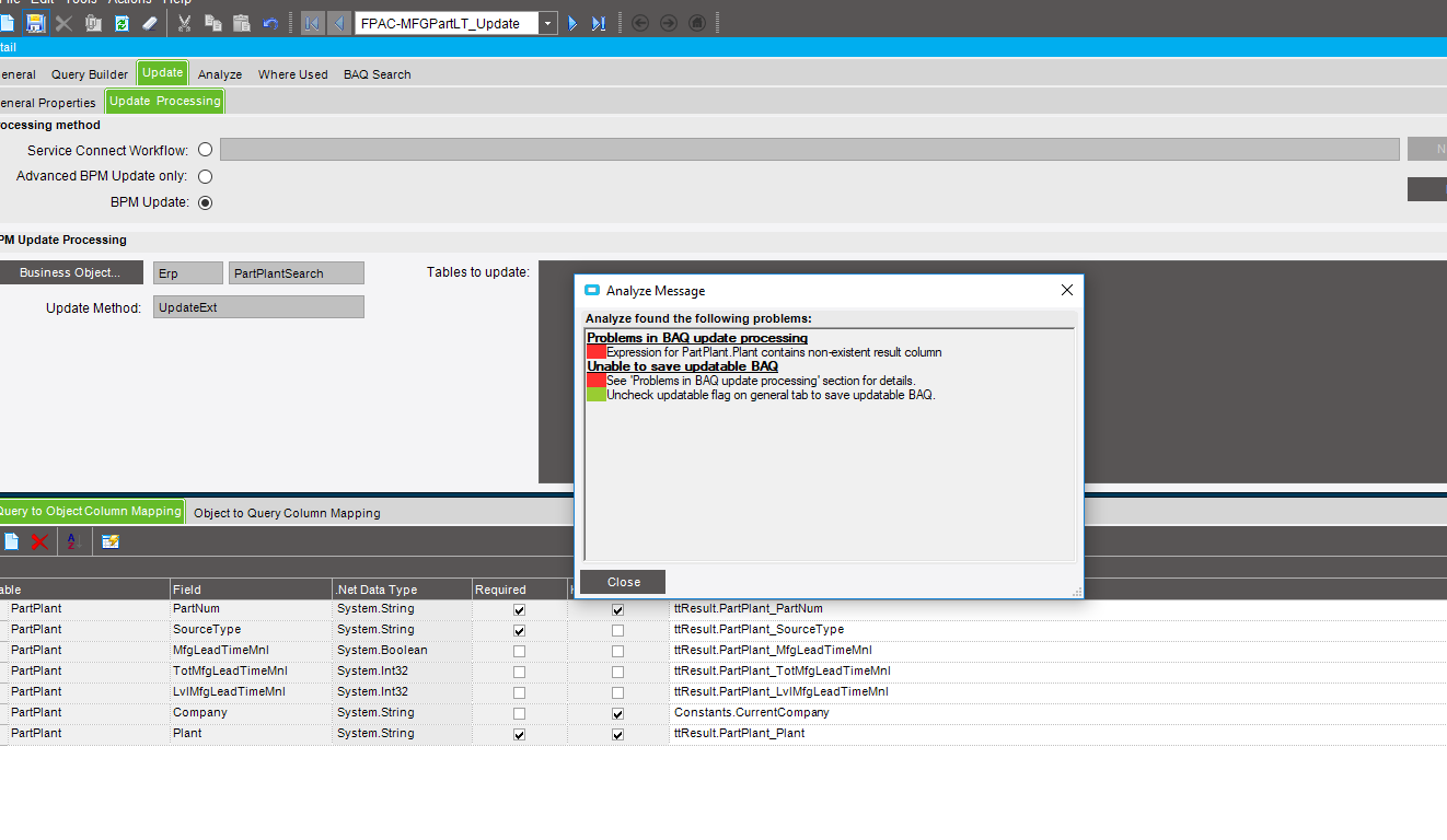

Well I tried to remove Plant from my existing BAQ and got errors…So I started over and still getting errors. Sometimes I don’t like updatable BAQs…LOL

And before you start thinking this is the issue, do a quick check to see if the Plant is in different cases of the tables selected (just include that field from all tables).
So I updated all my parts to MfgSys…do you think the need to be Mfgsys instead? I think this is my issue.
First off, I thought there was more than one table, and your uBAQ was retrieving the Plant field value from one table, but then trying to update a different table.
And while “MfgSys” doe equal “Mfgsys” when retrieving the data, updating a record with “Mfgsys” as its value, with a dataset containing “MfgSys”, may fail.
If it is just one table in the BAQ this shouldn’t be an issue at all.
I also have the Part table because I am pulling the Part Description. So I guess they need to be the same too. I wonder if they were different in each part.
I knew that the Plant field was case sensitive now and when importing data i always make sure it is all the same. Odd that when Epicor upgraded our DB during the conversion that they didn’t have it all be the same.

Can you share a pict of the uBAQ? Just to see what tables you’re using, and what relationships

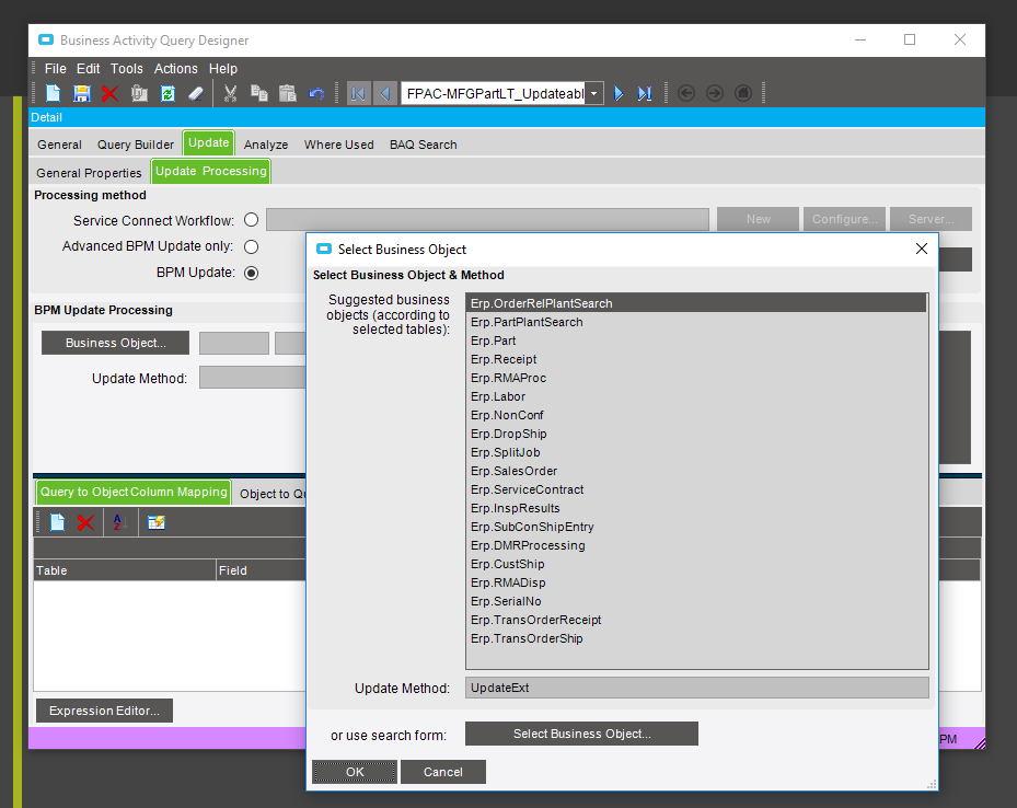

The business object in the pic says PartPlantSearch. That seems odd to me. Maybe try a different one?

I thought that was odd too but Part Plant was not an option. Do you think Part would work? But the fields are in Part Plant

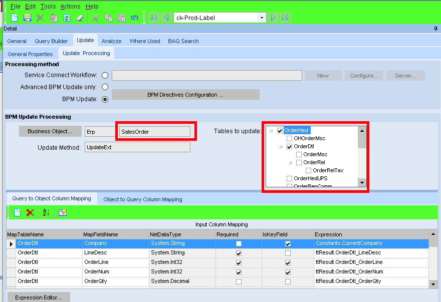

Don’t forget that the “Part” in that list refers to a BO, not a table.
Edit:
And when you select the BO, the related tables will show:
In my uBAQ, I needed to update the OrderDtl table, but had to select the SalesOrder BO. Then in the Tables to update, OrderDtl could be selected.
