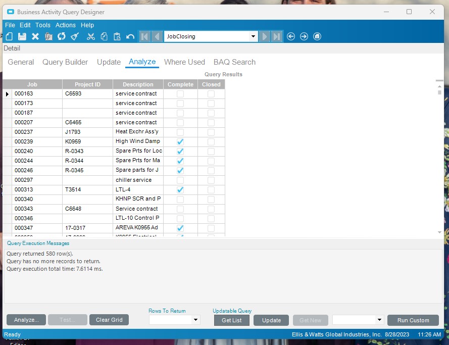

I created a uBAQ to close jobs. I ran a trace of a manual close and noted all the BOs. I used advanced BPM to create the base transaction. Everything appears to work, but it doesn’t actually update the record and I can’t figure out why. I must have missed a step somewhere along the line.

I figured out the problem. I had it updating the wrong tables fields. Working great now.
