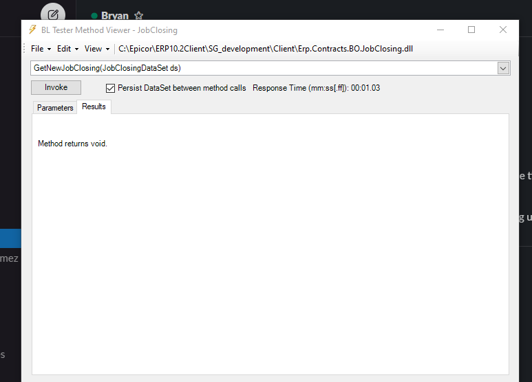

Do you have the BL tester set up? This will show you the methods that are available. Just looking at the list, you will start with GetNewJobClosing(), then call OnChangeJobNum()… etc.
Should should be able to call all of this with widgets in the bpm. Start your trace from right when you open the screen and go until after you closed it. You can leave out the searches, but call everything else.
