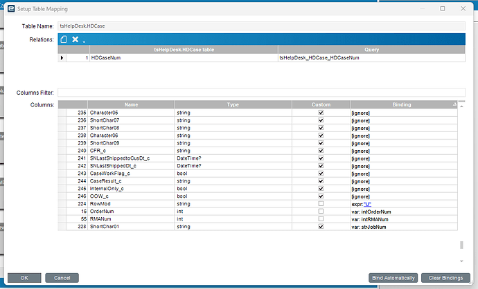

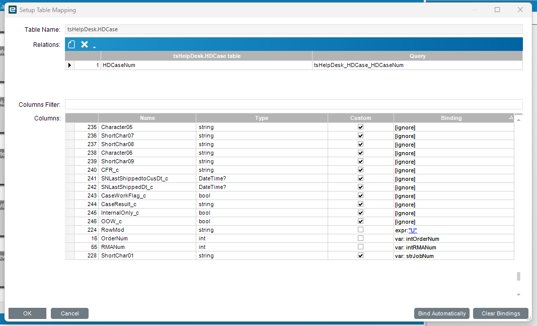

I have narrowed down the widget to the Update table by Query widget.
Apparently, it doesn’t like updating the RowMod to “U”… odd…

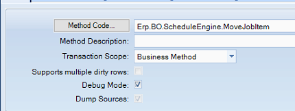

@knash If you check debug mode it compiles differently and drops the source in your
Server\BPM\Sources(BO, Dt or UBAQ) directory. On every save you will get a new folder.

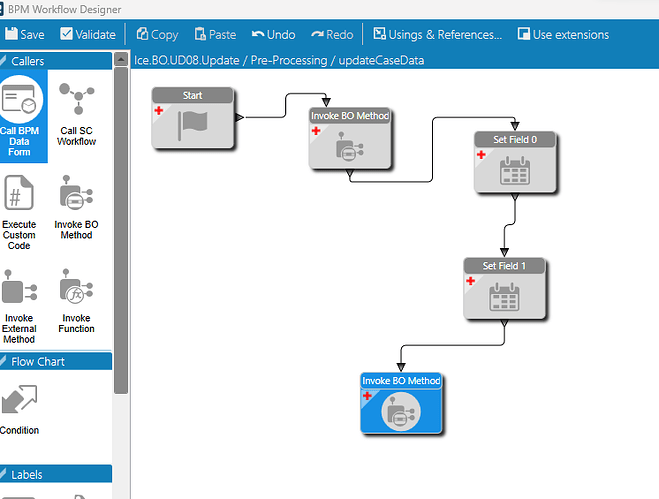

I broke out the portion of the that was causing the issue to make it easier to test.
There are only a few widgets.
GetByID the HDCase
set field shortchar01 to a value.
set field rowmod = “U”
Update HDCase
Then the error occurs.

I used BL Tester and the call worked!!
This has to do something with setting RowMod to “U”.
Just redid the BPM to use UpdateExt and it works.
