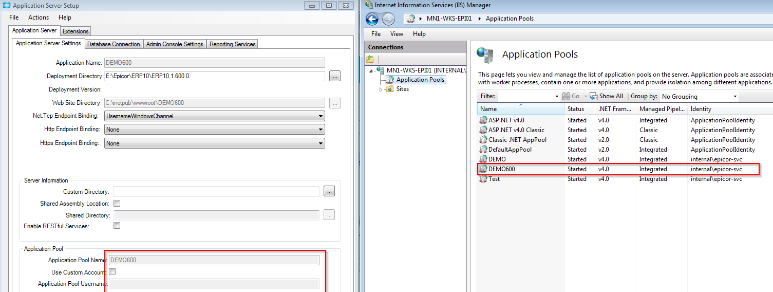

Assuming your database upgrade was good, did you try going to IIS and entering the username & password for the App pool, assuming you have an account to use for this? Sometimes the EAC does not show what the App Pool is using. Is there more information in the Windows event log?
