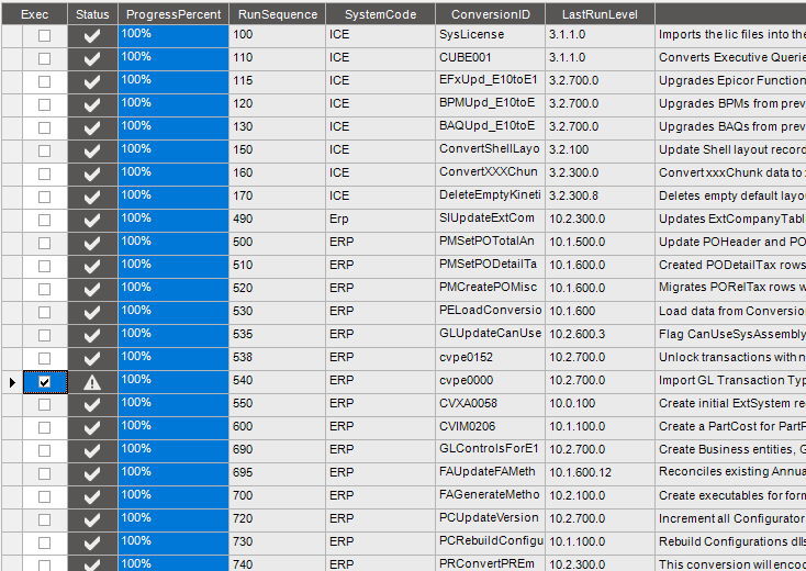

Ok, I think I did it, but the conversion workbench fails at Import GL Transaction Types, I can’t login as myself only as manager, I am so worried I deleted everything
You can’t login until all the Conversion Workbench programs are ran successfully. If one of them fails, you can review the errors, then fix them.
ok, thank god… hahah, I just logged in as manager and didn’t see any jobs, or anything, so I am dying but I am still going through this, I have done this before, a few times actually, but I dont remember it being this heart pounding
you are in Epicor? is that what you mean? or does the conversion workbench still opening when you log in?
yeah, the workbench is still open, i am so confused, I am getting this now, I am looking on here for how to fix it, just trying to sort through it, unless you already know what it is

Are you sure there is not another conversion program that failed? Unless I am wrong, if the posting rules program don’t succeed, it should not prevent you from opening Epicor.
It’s the only program in error, correct?
Have you installed the latest patch?
yes that is the only error, and that is base 700, do you think going up to 700.10 might fix it or could it make it worse?
I STRONGLY recommend that you install the latest patch. I’ve done tons of upgrades and never ran into this… but I never, never performed an upgrade on the base version.

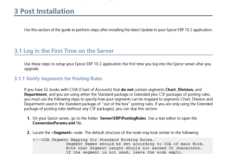

These error suggest the mapping of the segments is not right. I am sure this is mentioned in the upgrade guide somewhere (I don’t have it at hand right now to check).
this is the section I am refering to.
Yeah, I had checked that, but at the end, I just kept making the server worse. I was prepping my pink slip, to make the exit quicker and I finally just restored the server and thankfully, the backup worked hahah. Thankfully, I do a pretty good job taking care of the network so my backup worked fine, so I need to double down today.
We do not utilize Chart, Division or Departments and I could not find a conversionparams after the update, now that I have a clean slate, I will whip out my magnifying lens and focus more on the document. I must have missed something, I have updated a few times before successfully, but something changed along the way.
