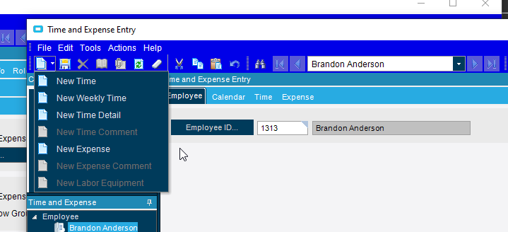

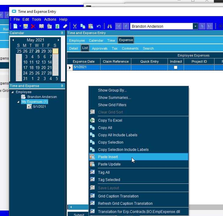

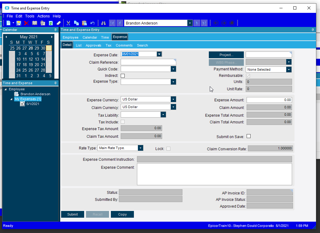

You’re question is a little vague. You can enter them in the time and expense entry screen easy enough. If you format your file you can even use paste insert and insert a bunch of expenses at a time.

Yes, we could enter them in by person and paste them in the lines, but we have many employees with many expense lines. For example: Jane would have 10 expense lines and John would have 20 expense lines, from our concur Expense download.
