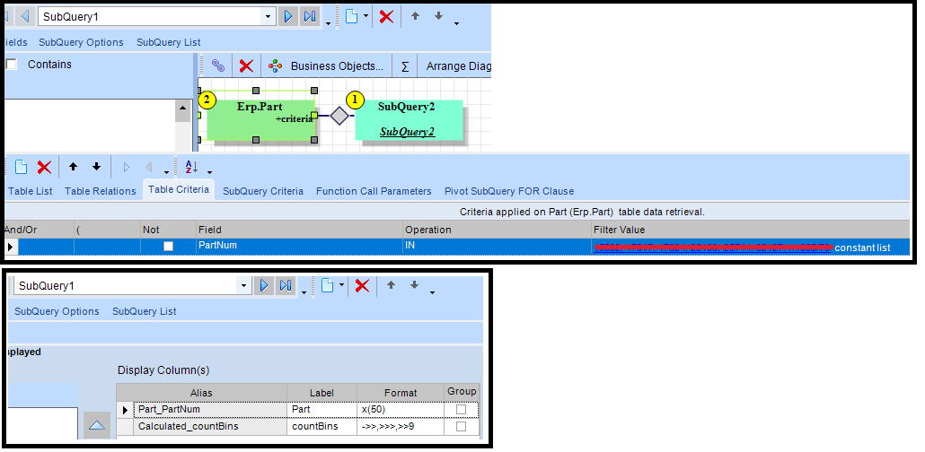

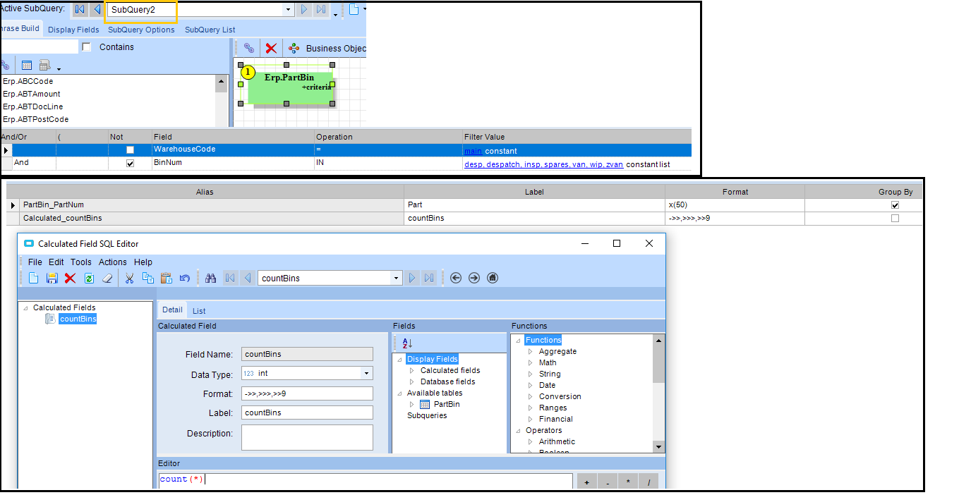

In the image below, Subquery2 is the inner query that contains the “count” function and ignores some specific bins.
Subquery1 is the toplevel. i’ve selected a few parts to test.
the query phrase would be helpful here.
please see attached images for query phrase builder tables for both queries.
the attached images did not come through.
sorry my bad, i will upload it
What does the link to the subquery look like? Does it include company? Are you multi-company?

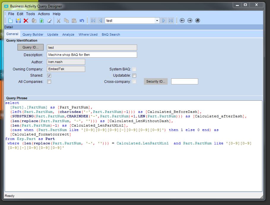

That is not the query phrase I was asking for.
here is the location. You should then be able to copy and paste like this.
select
	[Part].[PartNum] as [Part_PartNum],
	(left(Part.PartNum, (charindex('-',Part.PartNum)-1))) as [Calculated_BeforeDash],
	(SUBSTRING(Part.PartNum,CHARINDEX('-',Part.PartNum)+1,LEN(Part.PartNum))) as [Calculated_afterDash],
	(len(replace(Part.PartNum, '-', ''))) as [Calculated_LenWithoutDash],
	(len(Part.PartNum)-1) as [Calculated_LenPartMin1],
	(case when (Part.PartNum like '[0-9][0-9][0-9][-][0-9][0-9][0-9]') then 1 else 0 end) as [Calculated_formatcorrect]
from Erp.Part as Part
where (len(replace(Part.PartNum, '-', ''))) = Calculated.LenPartMin1  and Part.PartNum like '[0-9][0-9][0-9][-][0-9][0-9][0-9]'

The link between queries is just Part.PartNum = PartBin.PartNum.
There is only one company.
There are multiple warehouses but I’ve put the filter in.

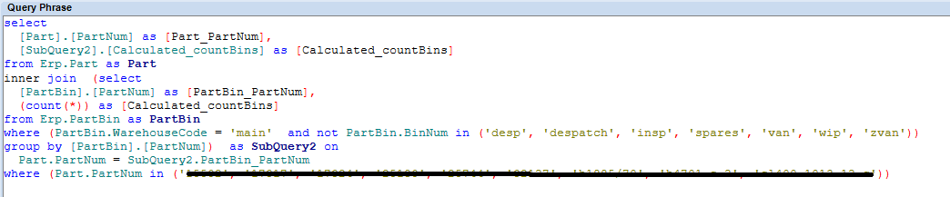

here it is.
select
[SubQuery2].[Calculated_countBins] as [Calculated_countBins]
inner join (select
[PartBin].[PartNum] as [PartBin_PartNum],
(count(*)) as [Calculated_countBins]
from Erp.PartBin as PartBin
where (PartBin.WarehouseCode = ‘main’ and not PartBin.BinNum in (‘desp’, ‘despatch’, ‘insp’, ‘spares’, ‘van’, ‘wip’, ‘zvan’))
group by [PartBin].[PartNum]) as SubQuery2 on
Part.PartNum = SubQuery2.PartBin_PartNum
where (Part.PartNum in (‘Part1’, ‘Part2’, ‘Part3’))

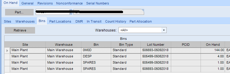

In our E10 database, there are certain parts with different lot numbers in the same bin number, therefore on part tracker there are multiple duplicate fields.
For the part on the example below, I would expect the count result = 3, not = 4 (which is what i am getting).
