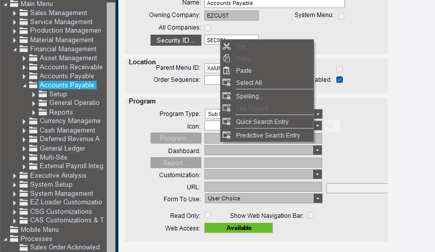

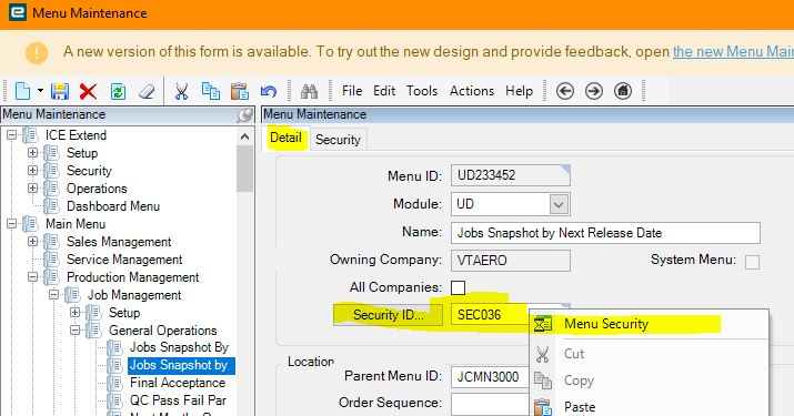

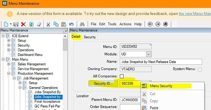

When you are in Menu Maintenance and you click on a menu item there is a security code attached to it. Right click on the security code and see if you can open the maintenance app that way.
My right click on security code. I think I know where to find that though.
Stay on the detail tab.
No dice, same thing that way too.
Dang! Well huh! Is your user account a security manager? Maybe it is disabled for you?
Ya my acct is Sec Mgr. :slight_smile:

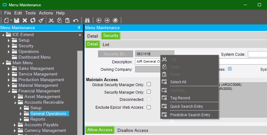

Check out this. Maybe you can create securities from menu maint.
Menu Maintenance - Security ID - Epicor ERP 10 - Epicor User Help Forum
