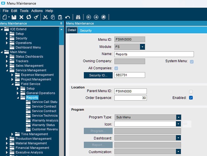

  1. in the menu, there is a SecurityID. The only place i can find this list is in the menu. Is there another place we should be assigning securityID? What does it control?

  1. The menu tab and security tab are at the top of the screen. On the menu tab you see the security id. That controls that particular menu item. This CAN affect those items below it as you can’t get to the lower items unless you can get to this one.

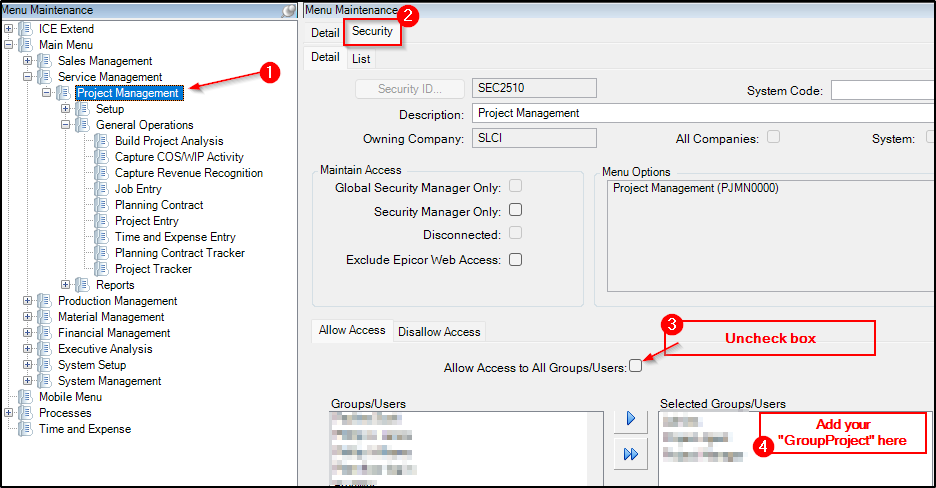

This should get you started. You will need to do this for each menu item.
This does not completely lock down your system it is only the beginning.
To assign User “A” to be able to access Project Entry
Open Menu Maintenance
click on Service Management
Click on the Security tab
Add the following
Click on Project Management
Add the following
Click on Project Entry
Add the following

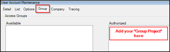

Open User Account Security Maintenance
Select User “A”
Add you “GroupProject” here
