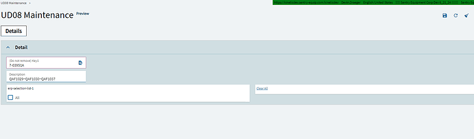

So i have a list of selections i would like to use a Selection List and the list is from a UD codes.

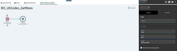

I have created rest event to get the data and populate the data view in the screen. The event is based on after the get by ID.
I can see the rest call get called successfully and the data view get populated and i can see the data in developer tools.

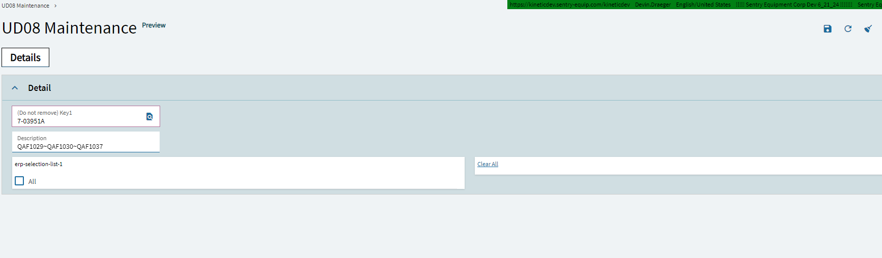

When i preview the application my selection does not have any of my selections from the new dataview.

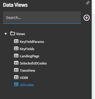

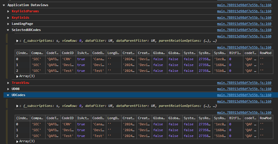

DataViews

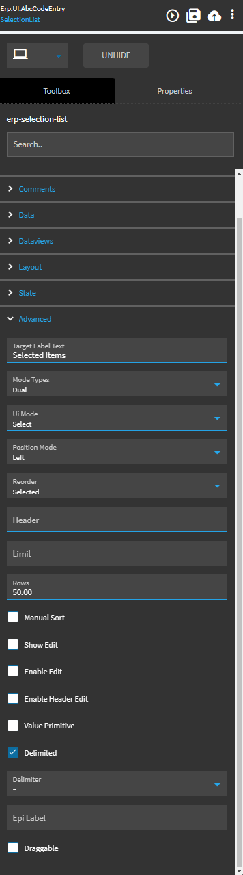

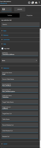

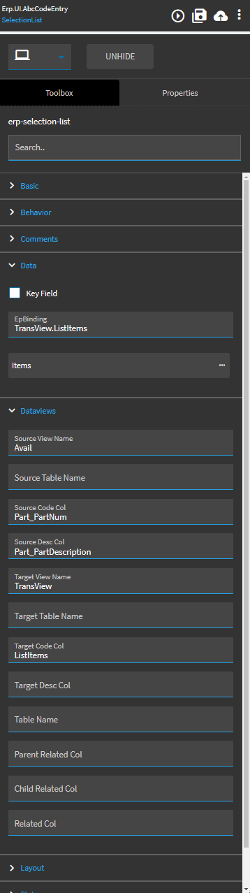

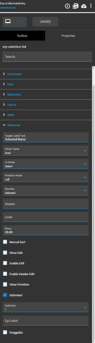

Configuration on the Selection List

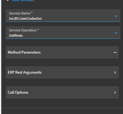

Here is the Rest Event

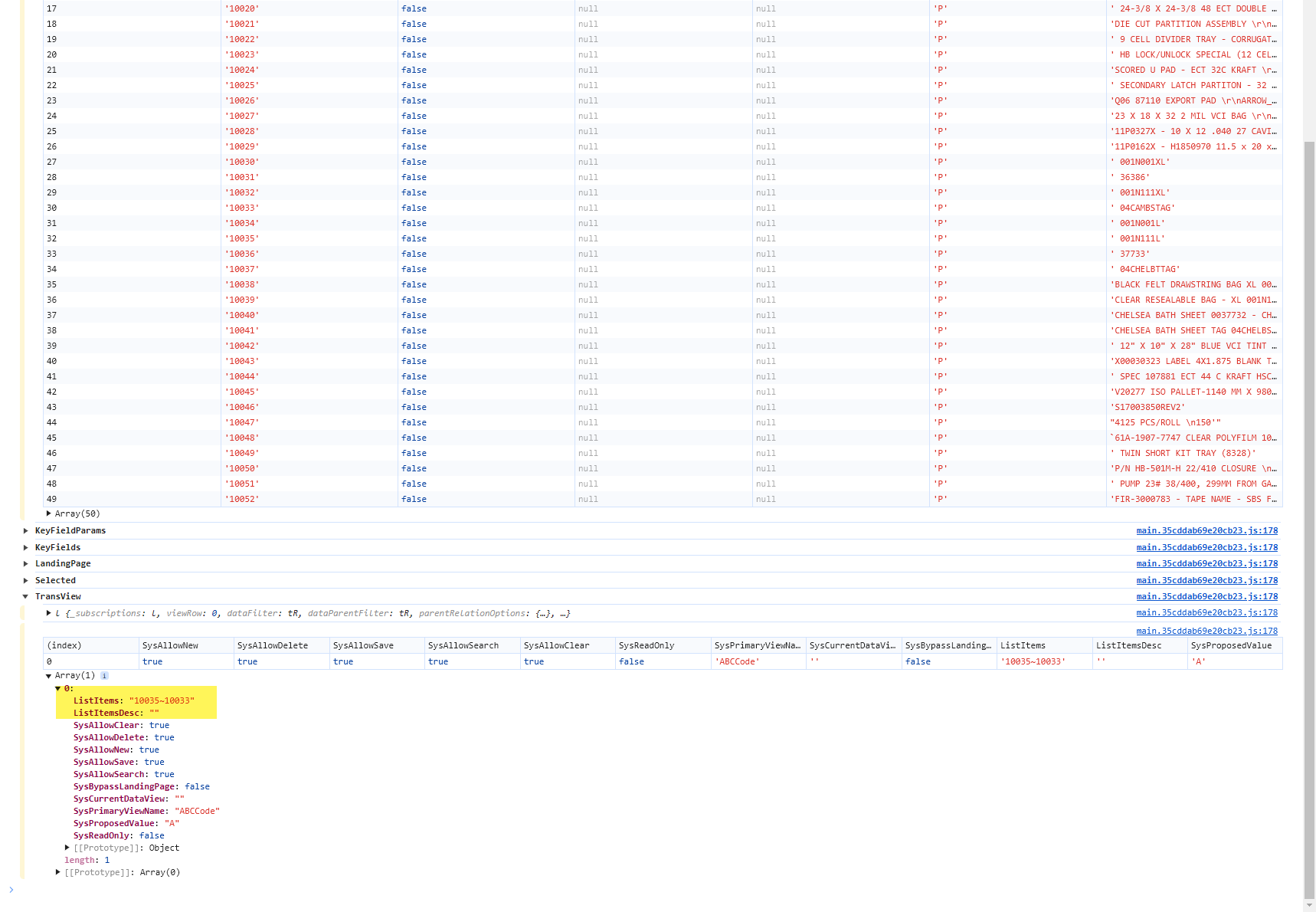

Here is the data return from the rest call

this is an error i am seeing in the debugger
not sure if this help or not.

Okay, I had to fight with this a bit.
The biggest takeaway is make sure everything is initialized before the control is painted. So, load data into all of your views (source and target) on load otherwise it gets cranky.

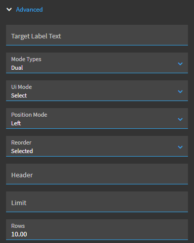

Also, take out the Target Desc Col field.

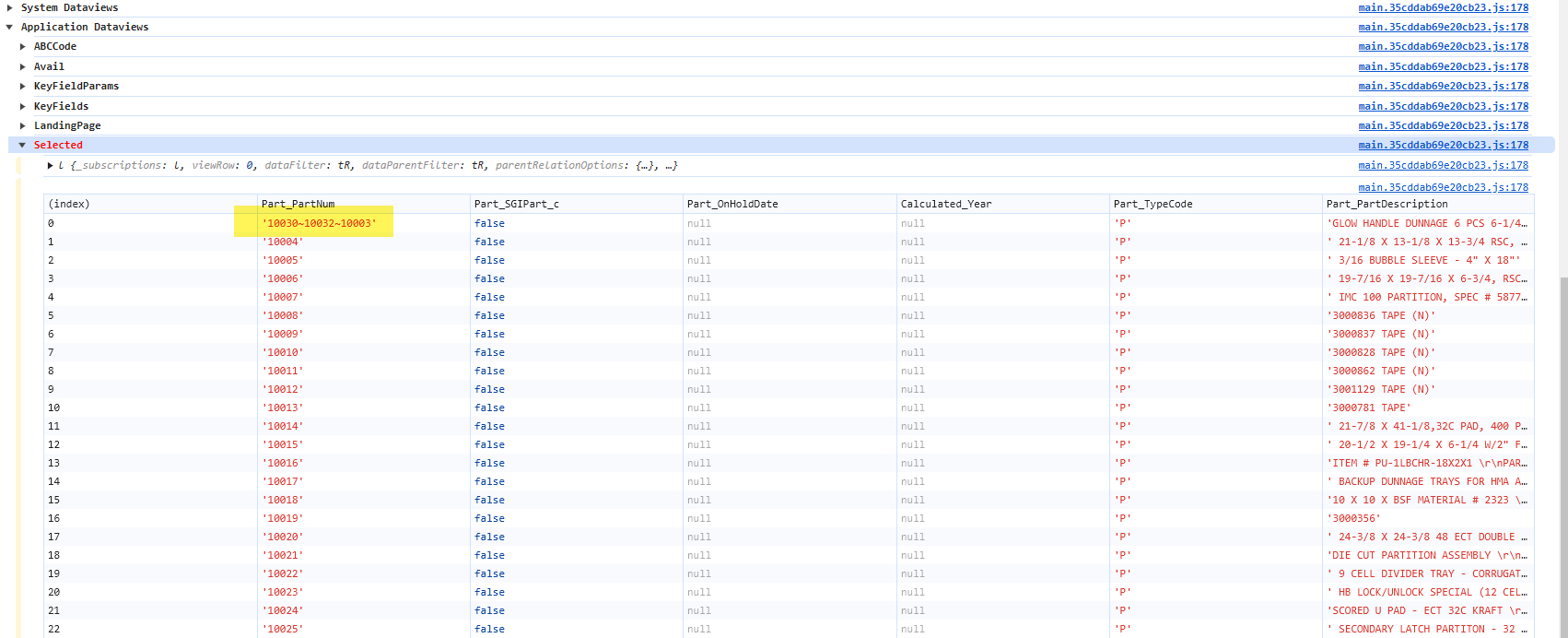

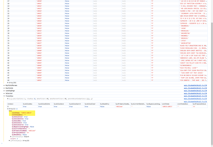

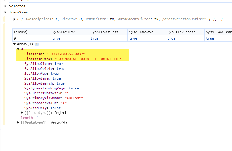

Here’s my setup which takes the list from a BAQ view and puts it into a TransView variable.
I should also point out that when you make selections and you have it set up to be a view, it’s going to save it to that view vs what you have in the epBinding.
Actually, you can do this too which lets you put the Target Desc Col in. This control is dumb.
** You can move the Source View Name to the Source Table Name too, I guess.
Also, if you’re populating data from the same table, you can omit the Source/Target Tables and just populate “Table Name.”

  		Service: Ice.BO.UserCodessvc
  		Service Method: GetRows
