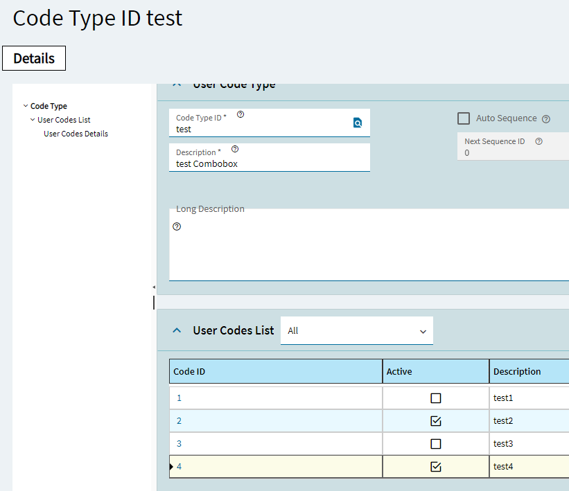

Yes, you can filter only the UDCodes.IsActive = true records.

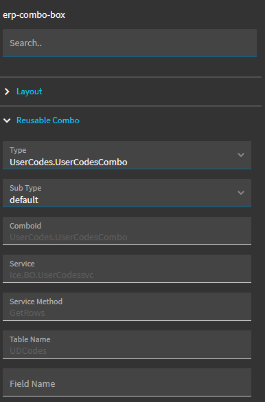

  1. Go To Reusable Combo

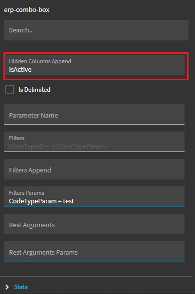

  2. Set Hidden Column Append

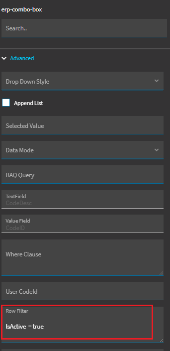

  3. Go to Advanced and Set Row Filter

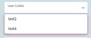

  4. Preview it.
