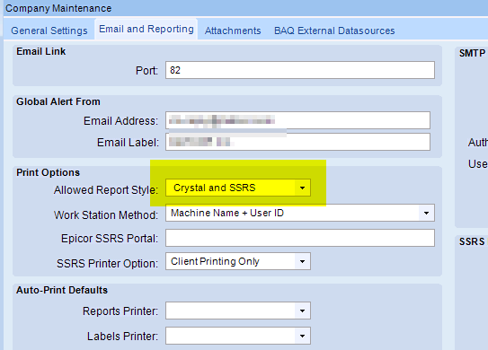

You’re probably not setup to use Crystal reports too. It’s in Company Maint

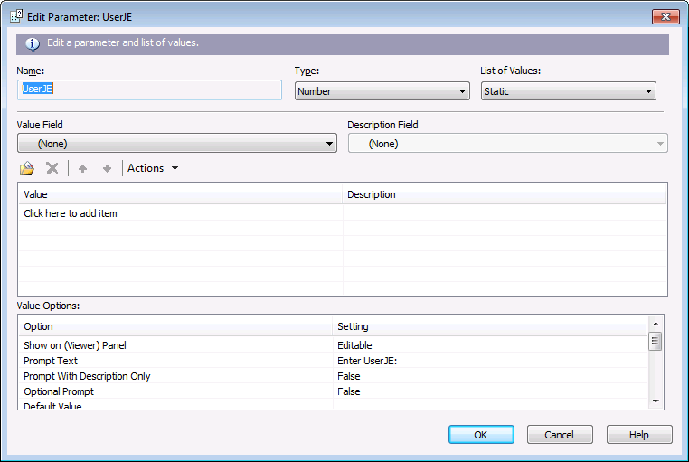

I tried just adding a Parameter to the SSRS based report (I use SSRS Report Builder - the program included with SQL Server), but that didn’t seem to force the user to enter a value.
