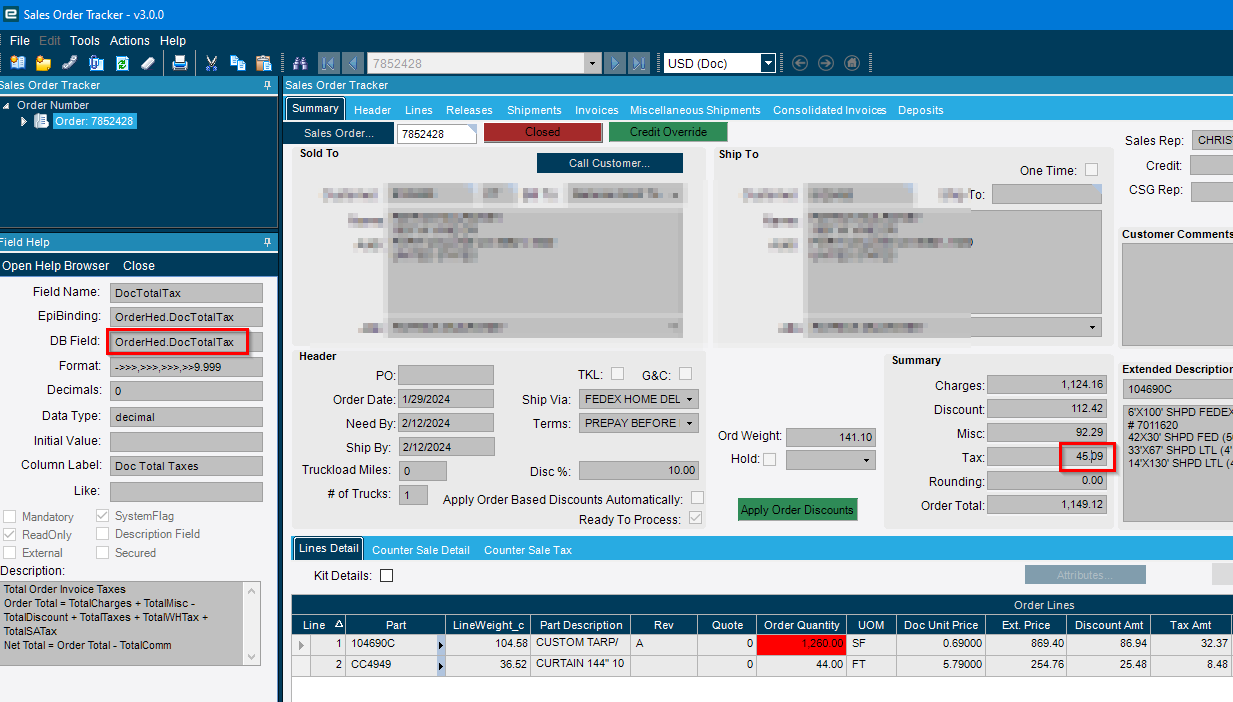

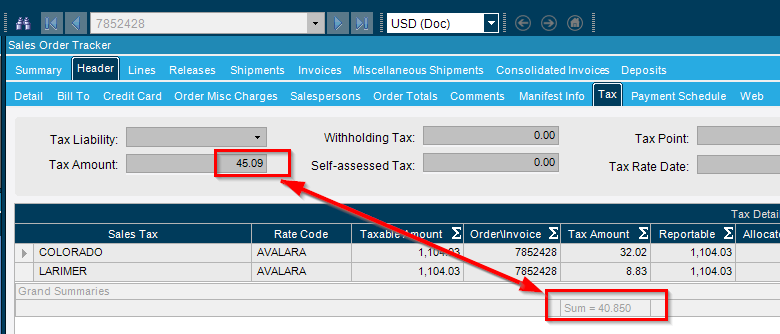

(Current issue is the Order Summary tab has incorrect tax amounts that are different than on the Order Header and Avalara Tax results tabs. Avalara says it’s Epicor, and Epicor says they can’t reproduce it, so the case sits.)
I can tag the orders to flag them, but I’m not sure how I’d get AI to sift through the data and find the nuggets (in this case, old and new tax amounts, and what changed between them). We’ve got systags, the Epicor DB (via BAQ export to excel?), with change logs.

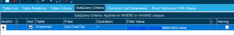

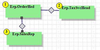

Whoa! I think that might be the key. OrderHed.DocTotalTax and TaxSvcHead.TotalTax should match, but don’t. I made a BAQ to show the orders where they don’t match. Time to figure out what BO to hook this BPM onto. Might as well add a SysTag as well.

I can attach the BAQ if anyone is interested in checking their data. SalesRep isn’t needed, I just added it in case there’s a pattern there…
