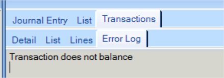

When I check the review journal for the error it says the transaction is out of balance.

If you go to the bank account for the other method does it have a GL control? I had something similar happen and it was resolving by adding GL to complete transactions and then remove again. Can you post full review journal error or was that exactly all it said?

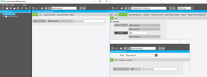

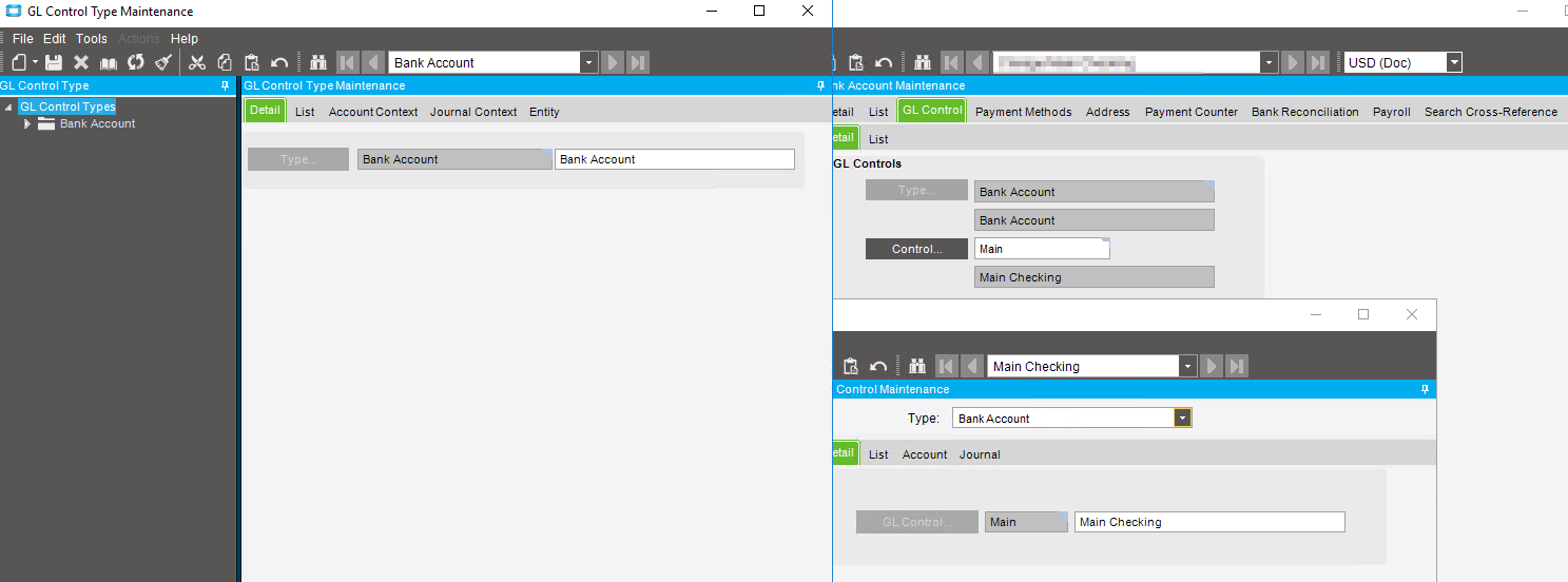

So I checked the GL Control that is associated with the bank and all of the contexts have not been set, any idea which context is needed?
Anything else you need from the Review Journal?
There is a GL Control defined for the bank, but when I review it and go to close out I get a warning that ‘One or more account context require an account’
Not sure which would be needed for Voiding.
None of the ‘Income Only’ contexts are defined, and ‘Cash’ has a checkbox that says required.
The Main Book Cash context is defined, along with all the other contexts except ‘AR Pending Cash’ which I wouldn’t think would be needed for this.
Would that be the issue? If so, perhaps the Controller would know the appropriate account to use there?
I would think cash but I am in the same boat as you with regards to Financials
make sure the entry for CASH is filled with a valid GL account - in the BANK GLC
and keep filling the other entries - if the errors persist
that would be my approach
