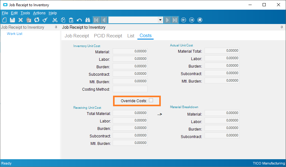

I have used “Override Costs” on Job Receipt to Inventory. However, that was for a Last-Costed part. I’ve never tried with a standard-costed part, since having it hit variance always made sense.
But then the shipment is at standard (as you said), so I think you’re still in the same place as before anyway.

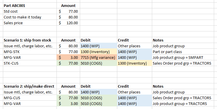

Also, on a tangent, I set the MFG-VAR account to go to COGS on the product groups we use for last-costed sales. Well, that was a mouthful. Let me try that again.
For a last-cost part, made direct to a sales order:
  • When you ship the job, all costs go to COGS
  • If you charge time or materials after that shipment, costs go to MFG-VAR
  • I set the account on a mfg-variance to hit our COGS account for certain product groups - the groups we use for last-costed, make-direct items.
My thought is that the costs were supposed to hit COGS anyway, so there’s no point in ths costs hitting the same variance account we use for, like, welding.

Rick, I’m going to make a plug for my idea again. I mapped this out a bit better.
So, the big assumption that I am making is that the product group that you sell it under is NOT the same as the group that you use when making it to stock. If they are the same, then, yes, my plan is hosed. Here, they are different.
When we make to stock, MFG-VAR always hits an account called “Manufacturing Variance.” That’s because stock jobs always use the product group on the part itself.
But for make-direct, we often use a different product group - the one that it will be sold under. Thus any variance hits COGS instead of… variance.
I did a test just now to verify this.

When dispositioning the warrantied part to a job, the override costs box must be checked and zeroed to prevent this part from coming back into WIP at cost and a credit against COS. If it is not checked, once the job is closed and completed WIP will be credited and COS will be debited. This will wreak havoc on the books if you have multiple COS GL accounts setup (standard sales, warranty/service, etc.). We also have to manually zero out the cost of the warrantied part on the job to prevent sales margin reports from being inaccurate since this data is pulled from the job.
