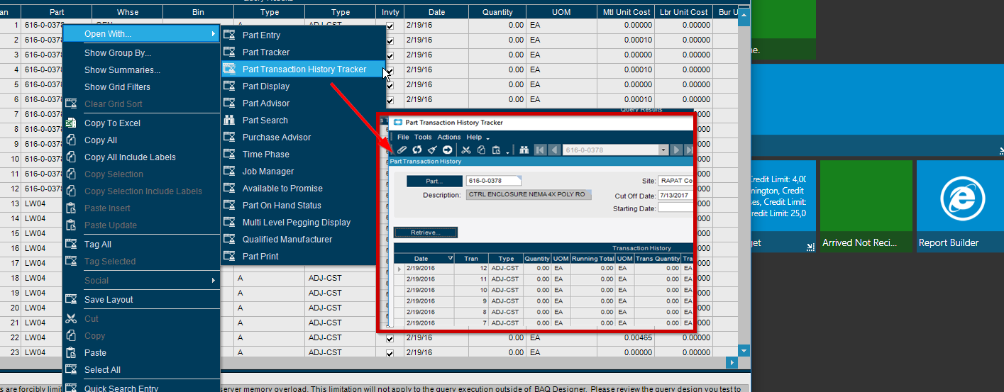

I don’t think you understand when I meant to look the PartTran table. That’s the database table that records all of that stuff for that. It cannot be empty. Also it’s not something that gets entered by hand. All of the things that happen that have to do with inventory is writing to that table. It’s not a function of if someone does it or not, it’s a core process that makes Epicor work. If you go to a part that you you and right click, open with, part transaction history, that’s the table it’s looking at.

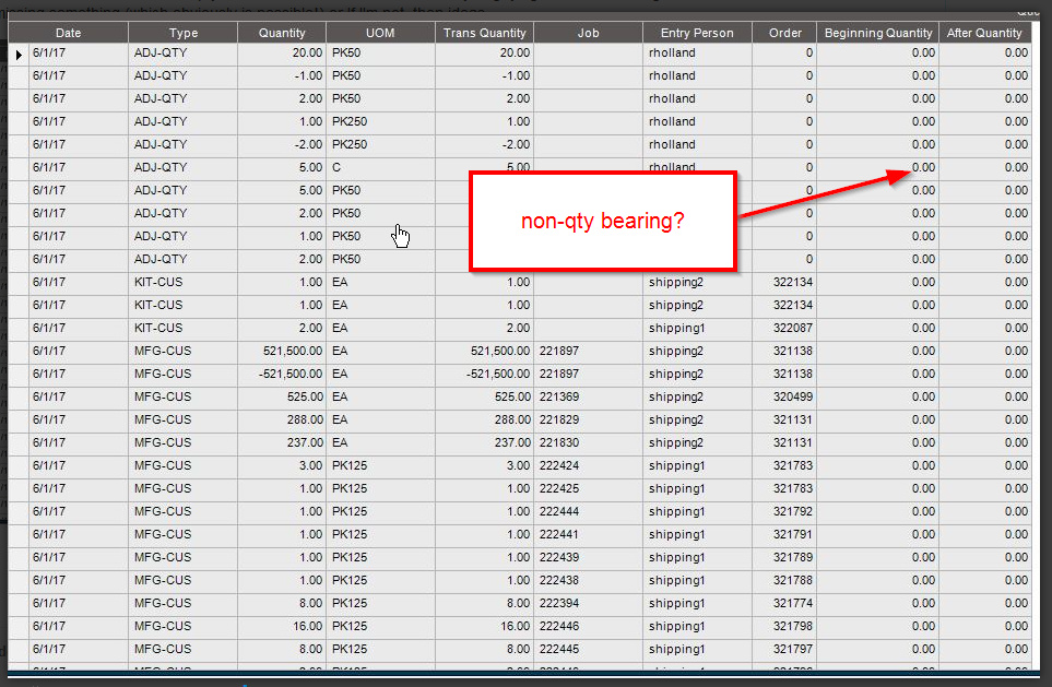

Didn’t think of that. That would make sense. If they do a physical every month, that would mean they don’t have live inventory (otherwise why would you count it each month). But all inventory non-quantity bearing? That’s interesting…

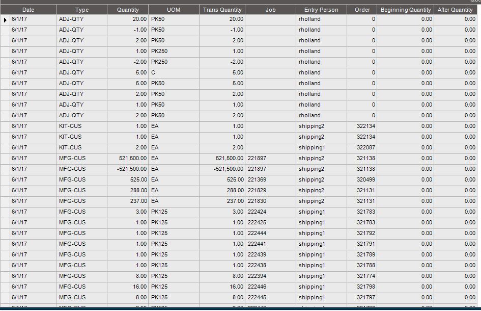

Ok, So, its not COMPLETELY empty. But seems useless for waste. Can you guys give me some insight as to if I’m missing something (which obviously is possible!) or If I’m not, then ideas…
So if you sort our your pur-xxx transactions (that’s what’s coming in) to your going out transactions xxx-cus or stk-mfg or whatever, you’ll have to look through the list. Then you have in’s and out’s and there will be a difference. That really should add up to what your adj-qty transactions are. So when you adjust your inventory you are basically accounting for scrap. If you have enough time and data in to smooth out the highs and lows you can get a running average of what your scrap rate is. You can do a query with a subQ of the “in” transactions summed and grouped by part number, and your “out” transactions summed and grouped by part number, then subtract the two, divide by your usage (outs) and you have a working scrap rate, based on history.

Also can you check in your part entry/tracker and see if the quantity bearing is set to true? The fact that the quantities aren’t changing is interesting.
I understand what you are saying. I do find this interesting and worth an in depth look. I checked a few parts quickly and saw they are Qty bearing. But 'm going to run a query and see for every part. I’ll be back with pics and questions… LOL! Thanks for the patience and info.
