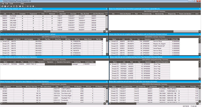

You might want to build yourself a Global Scheduling Exceptions Dashboard. I can probably export this one, since it was a community built Dashboard maybe from the EUG.
That looks pretty nifty! I would love to look at it on our end.
